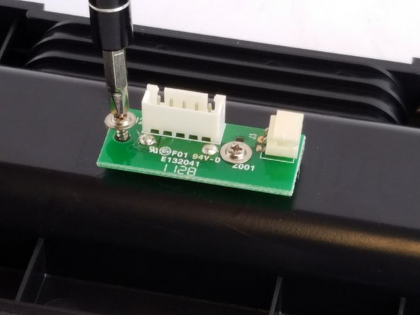

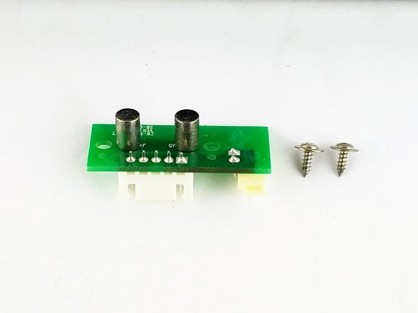

  7. iHome iW1 Speaker Charging Nodes Replacement, Charging Nodes: crwdns2935265:07crwdnd2935265:01crwdnd2935265:03crwdne2935265:0 iHome iW1 Speaker Charging Nodes Replacement, Charging Nodes: crwdns2935265:07crwdnd2935265:02crwdnd2935265:03crwdne2935265:0 iHome iW1 Speaker Charging Nodes Replacement, Charging Nodes: crwdns2935265:07crwdnd2935265:03crwdnd2935265:03crwdne2935265:0
    • Unscrew the two 11 mm Philips #1 screws on the charging nodes.
    • Remove the charging node from the speaker and set aside.
