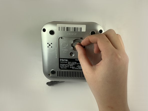

      • Turn the device over to access the bottom panel.
      • Locate the 6mm Phillips #2 screw under the label "unscrew to open door."
    2. iHome iPL8 Screen Replacement: crwdns2935265:02crwdnd2935265:01crwdnd2935265:01crwdne2935265:0
      • Using a Phillips #2 screwdriver, unscrew the captive screw.
      • Keep turning until the screw and the door are loose.
    3. iHome iPL8 Screen Replacement: crwdns2935265:03crwdnd2935265:01crwdnd2935265:01crwdne2935265:0
      • Lift and remove the battery access panel.
      • The captive screw will remain attached to the panel.
    4. iHome iPL8 Screen Replacement: crwdns2935265:04crwdnd2935265:01crwdnd2935265:02crwdne2935265:0 iHome iPL8 Screen Replacement: crwdns2935265:04crwdnd2935265:02crwdnd2935265:02crwdne2935265:0
      • Gently press on the rim of the 3V battery.
      • Remove the 3V battery.

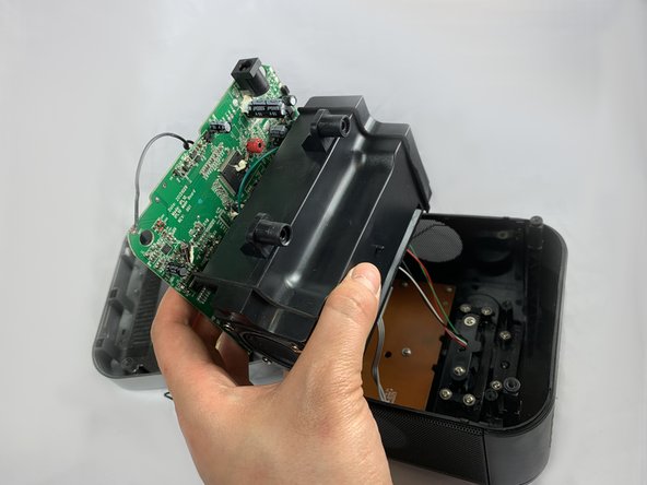

      • Locate the green circuit board. This panel is clipped onto two black, circular-shaped columns at two corners.
      • Pull out the green circuit board on the two corners.
      • The green circuit board is attached to a black box at the bottom. Flip the panel and the black box together to open the device.

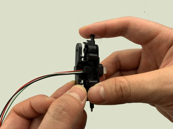

      • Remove the two 2.5 mm Phillips #1 screws securing the lightning dock assembly to the device.
      • Remove the two screws and the black cover.
      • Gently remove the lightning dock assembly.
      • The lightning dock assembly is connected to wires.

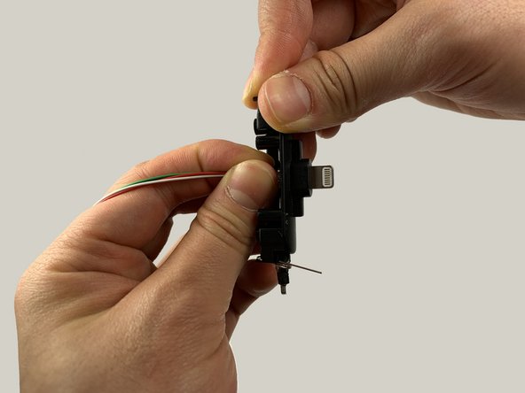

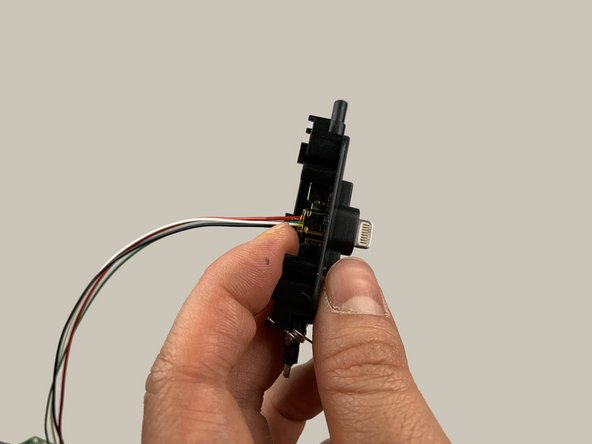

    5. iHome iPL8 Screen Replacement: crwdns2935265:09crwdnd2935265:01crwdnd2935265:03crwdne2935265:0 iHome iPL8 Screen Replacement: crwdns2935265:09crwdnd2935265:02crwdnd2935265:03crwdne2935265:0 iHome iPL8 Screen Replacement: crwdns2935265:09crwdnd2935265:03crwdnd2935265:03crwdne2935265:0
      • Remove the two 2.5mm screws using a Phillips #1 screwdriver.
      • Remove the back cover.
      • Use your fingers to reposition the lightning connector.
      • Make sure ALL of the lightning connector is exposed.

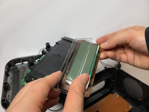

    1. iHome iPL8 Screen Replacement, Screen: crwdns2935265:010crwdnd2935265:01crwdnd2935265:01crwdne2935265:0
      • Look at the side of the device. You will see a green panel connecting to the black box by a white stripe.
      • Remove the four 2.5 mm Phillips #1 screws on the green panel.
      • Flip the green panel to reveal the front of the screen.
    2. iHome iPL8 Screen Replacement: crwdns2935265:011crwdnd2935265:01crwdnd2935265:02crwdne2935265:0 iHome iPL8 Screen Replacement: crwdns2935265:011crwdnd2935265:02crwdnd2935265:02crwdne2935265:0
      • Locate the transparent, rectangular plastic screen cover.
      • Gently lift the cover off.
      • The screen is now revealed. Replace the screen with a functioning one.
