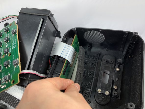

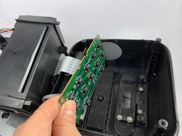

    1. iHome iPL8  Buttons Replacement, Buttons: crwdns2935265:010crwdnd2935265:01crwdnd2935265:03crwdne2935265:0 iHome iPL8  Buttons Replacement, Buttons: crwdns2935265:010crwdnd2935265:02crwdnd2935265:03crwdne2935265:0 iHome iPL8  Buttons Replacement, Buttons: crwdns2935265:010crwdnd2935265:03crwdnd2935265:03crwdne2935265:0
      • Locate the light brown, rectangular button board. Remove the five 2.5 mm Phillips #1 screws, four along the perimeter and one in the center.
      • Remove the brown button board.
      • There is a foam sheet underneath the button board. Use your hand to take it off and put it aside.

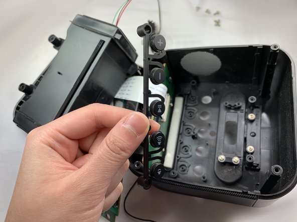

    2. iHome iPL8  Buttons Replacement: crwdns2935265:011crwdnd2935265:01crwdnd2935265:02crwdne2935265:0 iHome iPL8  Buttons Replacement: crwdns2935265:011crwdnd2935265:02crwdnd2935265:02crwdne2935265:0
      • There are two rows of buttons clipped on to the small, circular, black columns.
      • Gently unclip the two rows of buttons and remove them.
