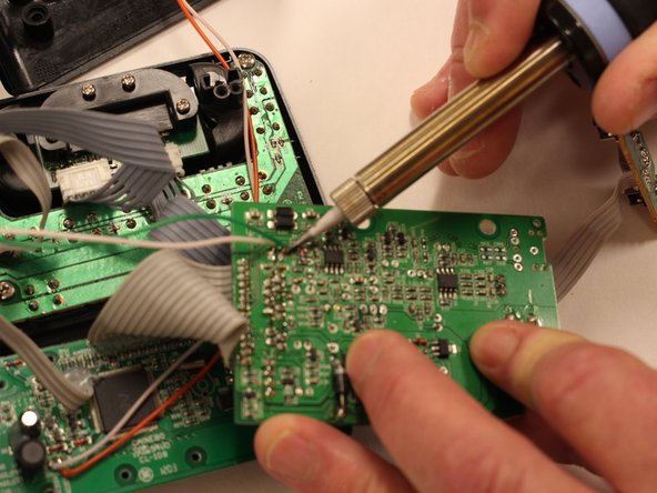

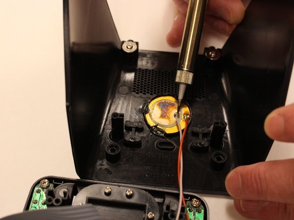

  6. iHome iP21 Motherboard Replacement, Cables: crwdns2935265:06crwdnd2935265:01crwdnd2935265:03crwdne2935265:0 iHome iP21 Motherboard Replacement, Cables: crwdns2935265:06crwdnd2935265:02crwdnd2935265:03crwdne2935265:0 iHome iP21 Motherboard Replacement, Cables: crwdns2935265:06crwdnd2935265:03crwdnd2935265:03crwdne2935265:0
    • Peel the glue from each of the three ribbon cable connections.
    • Remove the solder joints from the back of each ribbon cable.
    • Remove the ground wires by removing the solder joints on the back of the housing.

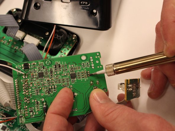

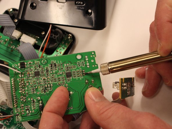

  7. iHome iP21 Motherboard Replacement, Detach cables from circuit board: crwdns2935265:07crwdnd2935265:01crwdnd2935265:03crwdne2935265:0 iHome iP21 Motherboard Replacement, Detach cables from circuit board: crwdns2935265:07crwdnd2935265:02crwdnd2935265:03crwdne2935265:0 iHome iP21 Motherboard Replacement, Detach cables from circuit board: crwdns2935265:07crwdnd2935265:03crwdnd2935265:03crwdne2935265:0
    • Remove glue from 3 ribbon cables from circuit board using fingers
    • Detach speaker cables from circuit board with soldering iron
    • Remove 3 ribbon cables with soldering iron
