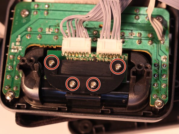

    2. iHome iP21 Docking Station Pin Replacement, Protective cover: crwdns2935265:04crwdnd2935265:01crwdnd2935265:02crwdne2935265:0 iHome iP21 Docking Station Pin Replacement, Protective cover: crwdns2935265:04crwdnd2935265:02crwdnd2935265:02crwdne2935265:0
      • Remove the four 4mm screws from the protective cover using the iFixit Phillips #1 bit

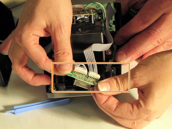

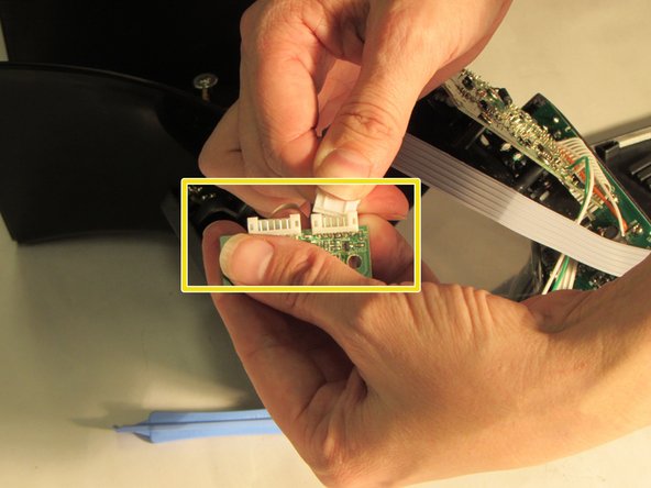

    3. iHome iP21 Docking Station Pin Replacement, Ribbon cables: crwdns2935265:05crwdnd2935265:01crwdnd2935265:03crwdne2935265:0 iHome iP21 Docking Station Pin Replacement, Ribbon cables: crwdns2935265:05crwdnd2935265:02crwdnd2935265:03crwdne2935265:0 iHome iP21 Docking Station Pin Replacement, Ribbon cables: crwdns2935265:05crwdnd2935265:03crwdnd2935265:03crwdne2935265:0
      • Grasp plastic cable connector ends
      • Remove the mini circuit board with 30-pin mounting dock from the two black plastic pegs.
      • Rock gently back and forth and pull to detach mini circuit board with 30-pin mounting dock attached.
