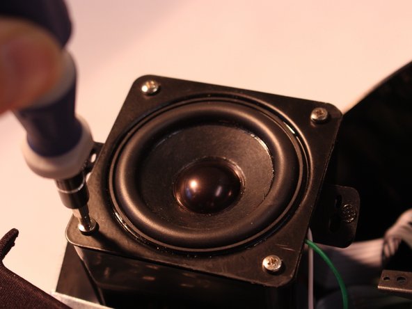

  3. iHome iP21 Display LED Replacement, Remove Speaker Assembly: crwdns2935265:03crwdnd2935265:01crwdnd2935265:01crwdne2935265:0
    • Remove two 9mm screws holding speaker assembly in iP21, using iFixit Phillips #2 bit
  4. iHome iP21 Display LED Replacement, Remove speaker from speaker assembly: crwdns2935265:04crwdnd2935265:01crwdnd2935265:02crwdne2935265:0 iHome iP21 Display LED Replacement, Remove speaker from speaker assembly: crwdns2935265:04crwdnd2935265:02crwdnd2935265:02crwdne2935265:0
    • Lift speaker assembly
    • Remove four 7mm screws to detach speaker from speaker assembly

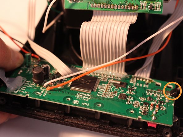

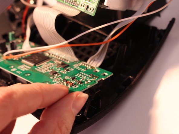

  5. iHome iP21 Display LED Replacement, Display circuit board: crwdns2935265:05crwdnd2935265:01crwdnd2935265:03crwdne2935265:0 iHome iP21 Display LED Replacement, Display circuit board: crwdns2935265:05crwdnd2935265:02crwdnd2935265:03crwdne2935265:0 iHome iP21 Display LED Replacement, Display circuit board: crwdns2935265:05crwdnd2935265:03crwdnd2935265:03crwdne2935265:0
    • Remove six 6mm screws from display circuit board.
    • Press black holding clips down and outward to release display circuit board.
    • Lift display circuit board to detach it from the housing.

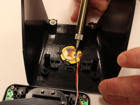

  6. iHome iP21 Display LED Replacement, Cables: crwdns2935265:06crwdnd2935265:01crwdnd2935265:02crwdne2935265:0 iHome iP21 Display LED Replacement, Cables: crwdns2935265:06crwdnd2935265:02crwdnd2935265:02crwdne2935265:0
    • Desolder the solder joints connecting the grounding cable to the display circuit board.
    • Remove glue from the ribbon cables with your fingers. Grasp and pull the glue to remove it from the circuit board.
    • Desolder the solder joints connecting the three ribbon cables to the back of the display circuit board.
    • Desolder the solder joints connecting the two grounding cables to the back of the display circuit board.
    • Desolder the solder joints connecting the two grounding cables to the back of the main housing.
