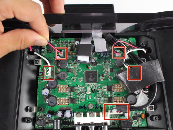

  4. iHome iP1 Motherboard Replacement, Motherboard: crwdns2935265:04crwdnd2935265:01crwdnd2935265:02crwdne2935265:0 iHome iP1 Motherboard Replacement, Motherboard: crwdns2935265:04crwdnd2935265:02crwdnd2935265:02crwdne2935265:0
    • Disconnect all five wire bundles attached to the motherboard by pulling them away from their connection.
    • The order in which the wire bundles are removed does not matter.
    • You may need to remove some black foam tape in order fully disconnect some of the wires.
