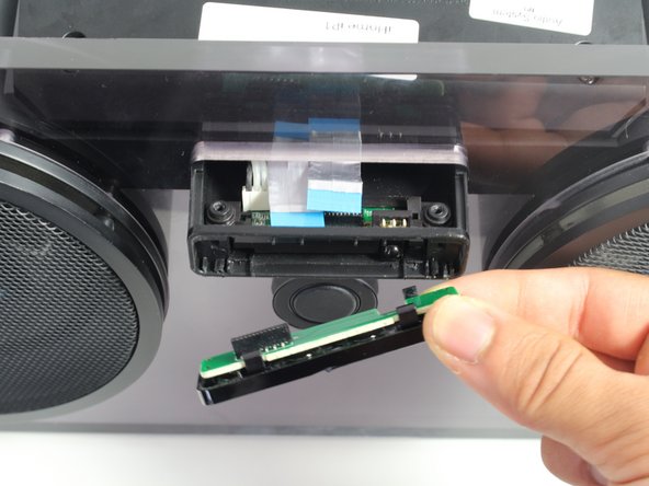

    • Orient the iHome upside down with the speakers facing you.
  2. iHome iP1 Buttons Replacement: crwdns2935265:02crwdnd2935265:01crwdnd2935265:01crwdne2935265:0
    • Remove the two 9.5 mm Phillips #1 screws from the dock cover.
  3. iHome iP1 Buttons Replacement: crwdns2935265:03crwdnd2935265:01crwdnd2935265:03crwdne2935265:0 iHome iP1 Buttons Replacement: crwdns2935265:03crwdnd2935265:02crwdnd2935265:03crwdne2935265:0 iHome iP1 Buttons Replacement: crwdns2935265:03crwdnd2935265:03crwdnd2935265:03crwdne2935265:0
    • Remove the dock cover by grabbing its sides and pulling it up and away from the faceplate.
  4. iHome iP1 Buttons Replacement, Buttons: crwdns2935265:04crwdnd2935265:01crwdnd2935265:02crwdne2935265:0 iHome iP1 Buttons Replacement, Buttons: crwdns2935265:04crwdnd2935265:02crwdnd2935265:02crwdne2935265:0
    • Disconnect the silver ribbon cable on the left-hand side by pulling away from the command buttons.
  5. iHome iP1 Buttons Replacement: crwdns2935265:05crwdnd2935265:01crwdnd2935265:03crwdne2935265:0 iHome iP1 Buttons Replacement: crwdns2935265:05crwdnd2935265:02crwdnd2935265:03crwdne2935265:0 iHome iP1 Buttons Replacement: crwdns2935265:05crwdnd2935265:03crwdnd2935265:03crwdne2935265:0
    • Remove the command buttons by pulling the small black panel containing them downward and away from the faceplate.
