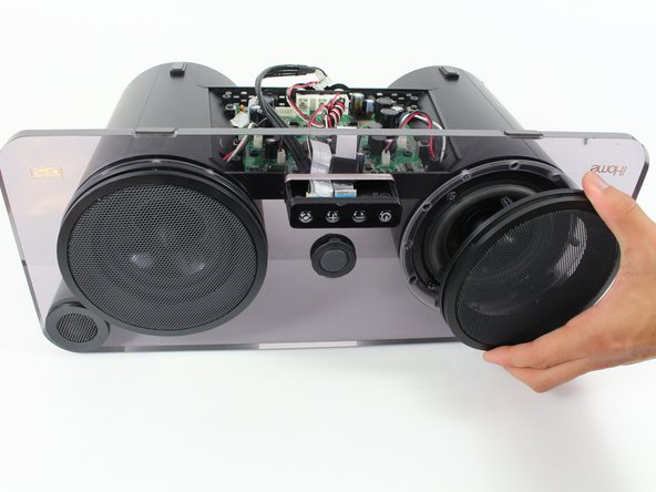

    • Rotate the iHome iP1 so that the speakers are now facing you.
    • Remove both of the speaker covers by pulling them off of the faceplate.

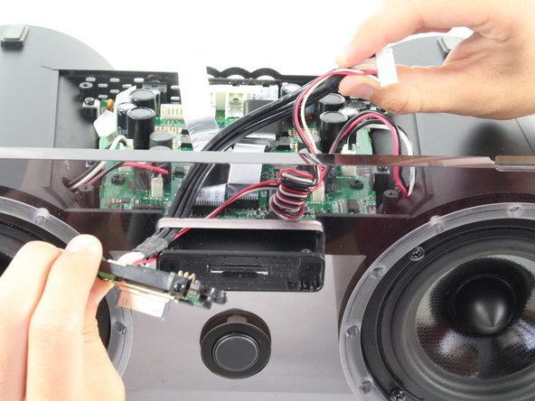

    • Unscrew the twelve 14.5 mm Phillips #2 screws holding the faceplate to the speaker housing. (There are six screws connecting the faceplate to each speaker.)
    • Completing this step will loosen the faceplate enough to pull the bundle of cables attached to the 30-pin connector through a hole in the faceplate, allowing the 30-pin connector to be removed from the iHome.
  11. iHome iP1 30-pin Connector Replacement: crwdns2935265:011crwdnd2935265:01crwdnd2935265:03crwdne2935265:0 iHome iP1 30-pin Connector Replacement: crwdns2935265:011crwdnd2935265:02crwdnd2935265:03crwdne2935265:0 iHome iP1 30-pin Connector Replacement: crwdns2935265:011crwdnd2935265:03crwdnd2935265:03crwdne2935265:0

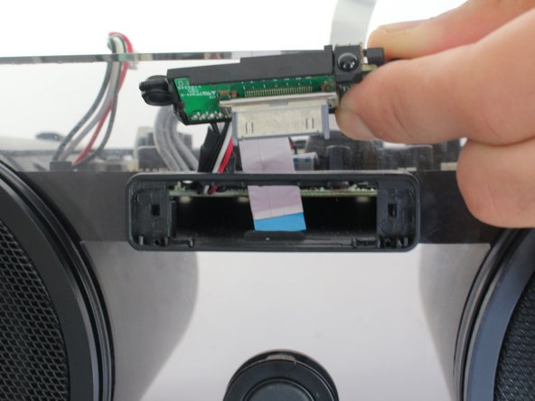

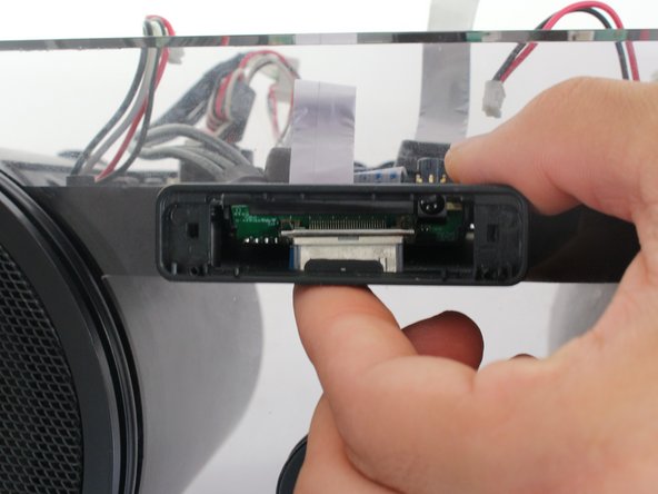

    • Detach the 30-pin connector from the dock housing by pushing it through the slot which it sticks out of.
    • Sometimes the 30-pin connector can get stuck in the dock housing, making it difficult to push through. To prevent this, push each side of the 30-pin connector evenly. This step can be accomplished without the use of any additional tools.
    • The command buttons have been shown as removed to show how to detach the 30-pin connector. However, it is not necessary to remove the command buttons in order to remove the 30-pin connector.

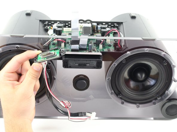

  12. iHome iP1 30-pin Connector Replacement: crwdns2935265:012crwdnd2935265:01crwdnd2935265:03crwdne2935265:0 iHome iP1 30-pin Connector Replacement: crwdns2935265:012crwdnd2935265:02crwdnd2935265:03crwdne2935265:0 iHome iP1 30-pin Connector Replacement: crwdns2935265:012crwdnd2935265:03crwdnd2935265:03crwdne2935265:0
    • Remove the 30-pin connector from the iHome by pulling the bundle of cables attached to it through the center hole in the faceplate.
    • You may have to wiggle the faceplate to be able to pull the bundle of cables through its center hole.
