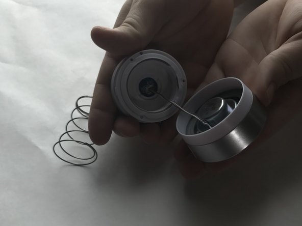

      • Push down and turn the top of the speaker clockwise. This will release the clips and expand the speaker.
    2. iHome iM71SC Spring Replacement: crwdns2935265:02crwdnd2935265:01crwdnd2935265:01crwdne2935265:0
      • Use a #000 Phillips screwdriver to remove the four 1 mm screws from the bottom half of the speaker.
    3. iHome iM71SC Spring Replacement: crwdns2935265:03crwdnd2935265:01crwdnd2935265:01crwdne2935265:0
      • Flip the speaker over and use a #000 Phillips screwdriver to remove three 1mm screws . Unscrew these to unfasten the top.
    4. iHome iM71SC Spring Replacement: crwdns2935265:04crwdnd2935265:01crwdnd2935265:01crwdne2935265:0
      • Remove the now unfastened coverings to expose the internals of the speaker.
    1. iHome iM71SC Spring Replacement, Spring: crwdns2935265:05crwdnd2935265:01crwdnd2935265:01crwdne2935265:0
      • Pry the spring from the speaker housing using the blue plastic pry tool.
    2. iHome iM71SC Spring Replacement: crwdns2935265:06crwdnd2935265:01crwdnd2935265:02crwdne2935265:0 iHome iM71SC Spring Replacement: crwdns2935265:06crwdnd2935265:02crwdnd2935265:02crwdne2935265:0
      • Unwind the old spring from the wires.
