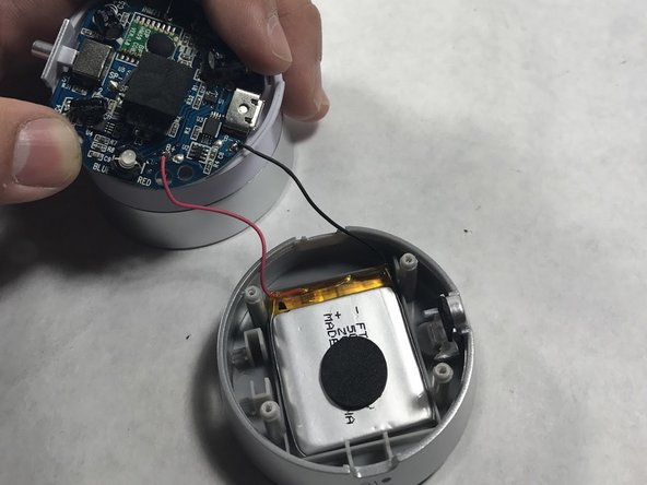

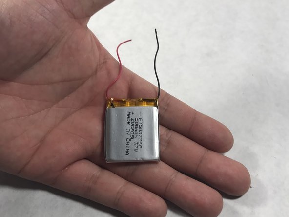

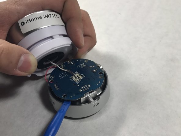

  5. iHome iM71SC Battery Replacement, Battery: crwdns2935265:05crwdnd2935265:01crwdnd2935265:03crwdne2935265:0 iHome iM71SC Battery Replacement, Battery: crwdns2935265:05crwdnd2935265:02crwdnd2935265:03crwdne2935265:0 iHome iM71SC Battery Replacement, Battery: crwdns2935265:05crwdnd2935265:03crwdnd2935265:03crwdne2935265:0
    • Locate the battery underneath the circuit board.
  6. iHome iM71SC Battery Replacement: crwdns2935265:06crwdnd2935265:01crwdnd2935265:02crwdne2935265:0 iHome iM71SC Battery Replacement: crwdns2935265:06crwdnd2935265:02crwdnd2935265:02crwdne2935265:0
    • Unsolder the batterie's wires from the circuit board to remove the old battery.
    • Check out this awesome guide for soldering & desoldering instructions.
To reassemble your device, follow Steps 1-4 in reverse order.
