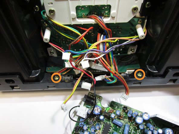

    • Unscrew the bottom of the iHome at the marked points with a #2 phillips
  2. iHome iH5 Speakers Replacement: crwdns2935265:02crwdnd2935265:01crwdnd2935265:01crwdne2935265:0
    • Remove wires from the logic board (tweezers or pliers are helpful)
  3. iHome iH5 Speakers Replacement: crwdns2935265:03crwdnd2935265:01crwdnd2935265:01crwdne2935265:0
    • Unscrew at the marked points with #2 Phillips screwdriver.
  4. iHome iH5 Speakers Replacement: crwdns2935265:04crwdnd2935265:01crwdnd2935265:02crwdne2935265:0 iHome iH5 Speakers Replacement: crwdns2935265:04crwdnd2935265:02crwdnd2935265:02crwdne2935265:0
