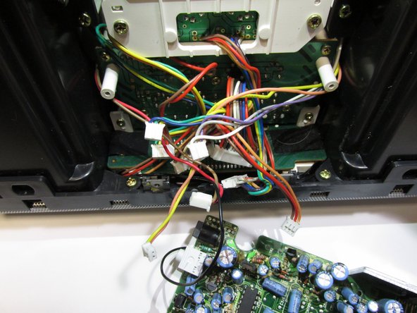

    • Pull cover back to access the inside.
    • Use tweezers (or pliers if wires are tight) to unplug the three wires.

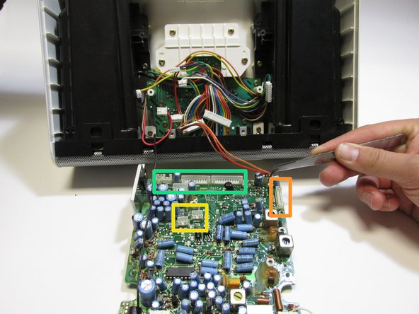

    • Flip the circuit board over so back is facing out.
    • There are capacitors all over the back side of the board. Be careful not to touch these capacitors (blue cylinders) as they can discharge—giving you a shock.
    • Remove the eight wires from the circuit board with tweezers. If the wires are tight 8" needle nose pliers might work better.
    • There is one wire to be removed in the orange box.
    • There are two wires to be removed in the the yellow box.
    • In the green box there are five wires to be removed.

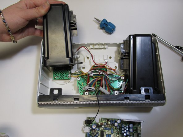

    • Remove the two 5/16 inch screws from the speakers and the bottom of the device with a #2 Phillips screwdriver.
    • Remove the two 5/16 inch screws from the speakers and the front of the device with a #2 Phillips screwdriver.
    • Gently pull the back of the speaker up (like the speaker on the right side of the picture. Then pull it straight back (as shown with the speaker on the left side of the picture).

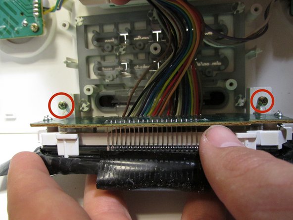

    • Pull back the electron tape covering the two screws on the screen display and remove the 1/4 screws with #0 Phillips screwdriver

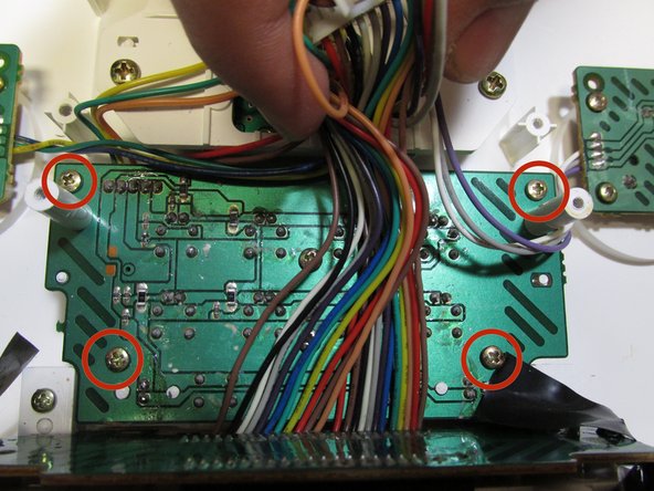

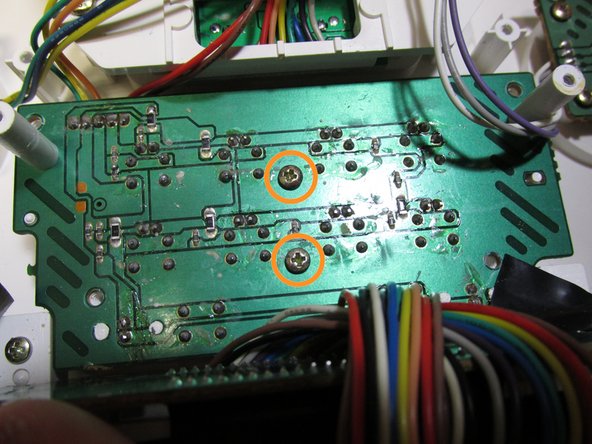

    • Remove the six 3/8 inch screws from the circuit board with a #2 Phillips screwdriver.
    • There are fours screws in the corners.
    • There are two screws in the middle (the wires have to be moved to see them).
