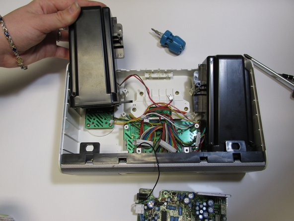

    • Remove the two screws from the speakers with a #2 Phillips screwdriver.
    • Turn the device on its front side and remove the two screws with a #2 Phillips screwdriver.
    • Pull the speaker up from the back as shown with the speaker on the right. Then pull the speaker straight back as shown with the speaker on the left.
