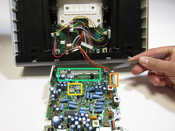

    • Flip the circuit board over.
    • There are capacitors all over the back side of the board. Be careful not to touch these capacitors (blue cylinders) as they can discharge—giving you a shock.
    • Unplug the eight wires attached to the circuit board with tweezers. If the wires are tight pliers might work better.
    • There is on wire in the orange box.
    • There are two wires in the yellow box.
    • There are five wires in the green box.
