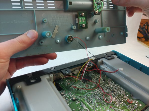

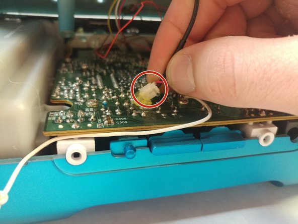

    • Slowly tilt the bottom cover of the iHome up.
    • Do not yank the cover off, there is a wire connecting the cover to the circuit board.
    • Disconnect the wire just by pulling on the connector gently.

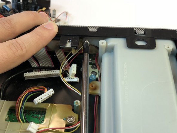

  4. iHome iH3L Scroll Wheel Circuit Board  Replacement: crwdns2935265:04crwdnd2935265:01crwdnd2935265:02crwdne2935265:0 iHome iH3L Scroll Wheel Circuit Board  Replacement: crwdns2935265:04crwdnd2935265:02crwdnd2935265:02crwdne2935265:0
    • Disconnect the next connector pin after slowly opening the lid more.

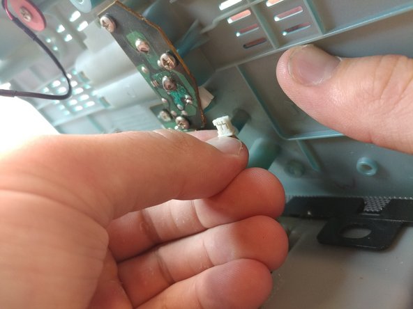

  5. iHome iH3L Scroll Wheel Circuit Board  Replacement: crwdns2935265:05crwdnd2935265:01crwdnd2935265:03crwdne2935265:0 iHome iH3L Scroll Wheel Circuit Board  Replacement: crwdns2935265:05crwdnd2935265:02crwdnd2935265:03crwdne2935265:0 iHome iH3L Scroll Wheel Circuit Board  Replacement: crwdns2935265:05crwdnd2935265:03crwdnd2935265:03crwdne2935265:0
    • Disconnect the final connector pin series and carefully set your lid behind the body of the iHome.
    • The tiny speaker will not be disconnected for this repair, but you can easily remove it from the lid by means of a paperclip from the outside. While not necessary, this can help prevent damage to your device.

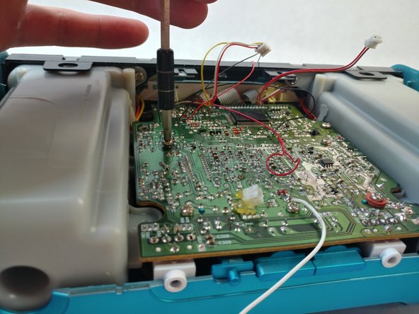

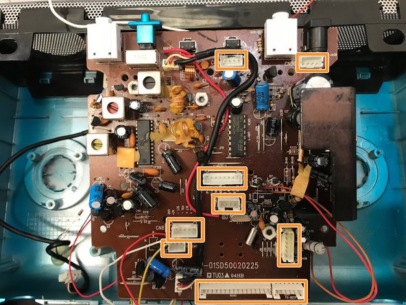

    • Remove the seven screws that are holding the motherboard in place:
    • Six 14 mm Phillips #2 screws.
    • One 14 mm Phillips #2 screw with two rubber washers on it.

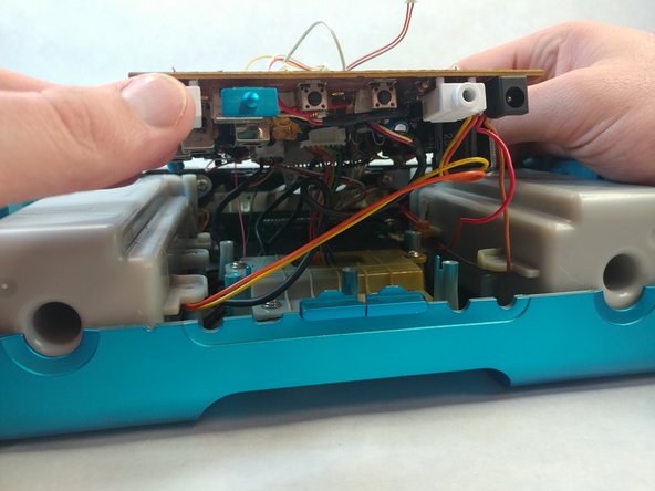

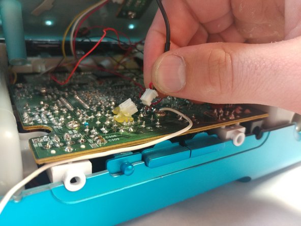

  7. iHome iH3L Scroll Wheel Circuit Board  Replacement: crwdns2935265:07crwdnd2935265:01crwdnd2935265:03crwdne2935265:0 iHome iH3L Scroll Wheel Circuit Board  Replacement: crwdns2935265:07crwdnd2935265:02crwdnd2935265:03crwdne2935265:0 iHome iH3L Scroll Wheel Circuit Board  Replacement: crwdns2935265:07crwdnd2935265:03crwdnd2935265:03crwdne2935265:0
    • To remove the motherboard, gently lift up from opposite sides.
    • Be careful when lifting the motherboard. There are wires still connected to it on the backside.

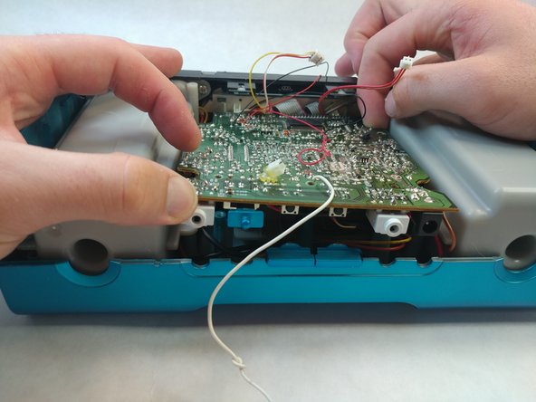

  8. iHome iH3L Scroll Wheel Circuit Board  Replacement: crwdns2935265:08crwdnd2935265:01crwdnd2935265:03crwdne2935265:0 iHome iH3L Scroll Wheel Circuit Board  Replacement: crwdns2935265:08crwdnd2935265:02crwdnd2935265:03crwdne2935265:0 iHome iH3L Scroll Wheel Circuit Board  Replacement: crwdns2935265:08crwdnd2935265:03crwdnd2935265:03crwdne2935265:0

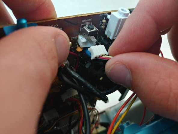

    • Carefully tilt the motherboard up from the front.
    • Disconnect the 8 connections by gently pulling on them. Starting from the front and work your way backwards.
    • All 8 connectors disconnected.

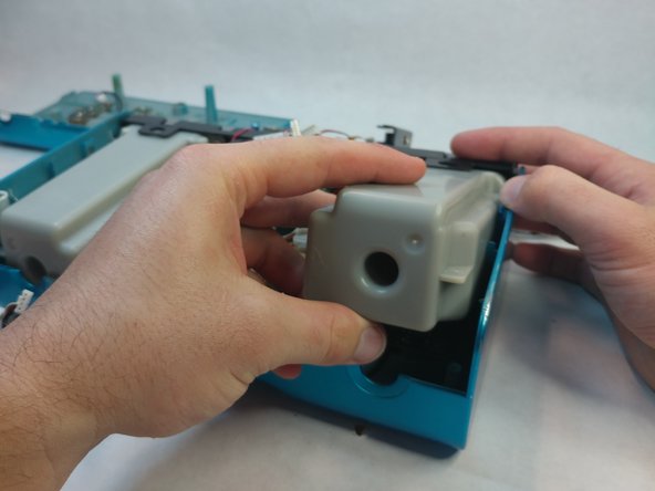

    • Unscrew the screws holding the speakers onto the body. One on each side:
    • Two 14.3 mm Phillips #2 screws.

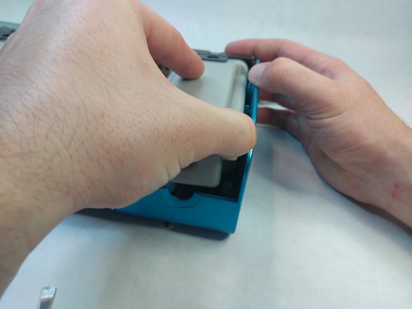

  10. iHome iH3L Scroll Wheel Circuit Board  Replacement: crwdns2935265:010crwdnd2935265:01crwdnd2935265:03crwdne2935265:0 iHome iH3L Scroll Wheel Circuit Board  Replacement: crwdns2935265:010crwdnd2935265:02crwdnd2935265:03crwdne2935265:0 iHome iH3L Scroll Wheel Circuit Board  Replacement: crwdns2935265:010crwdnd2935265:03crwdnd2935265:03crwdne2935265:0
    • To remove the speakers from the iHome, gently lift up the back of the speaker and pull towards you. These are very secure so minor shaking may help release the speaker.
    • Repeat for the other side.
    • Be careful yanking on them, the speakers are connected together.

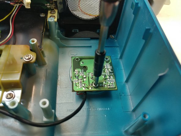

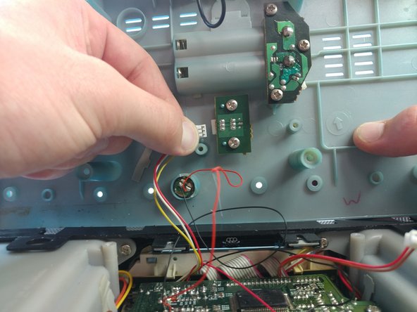

  11. iHome iH3L Scroll Wheel Circuit Board  Replacement, Scroll Wheel Circuit Board: crwdns2935265:011crwdnd2935265:01crwdnd2935265:02crwdne2935265:0 iHome iH3L Scroll Wheel Circuit Board  Replacement, Scroll Wheel Circuit Board: crwdns2935265:011crwdnd2935265:02crwdnd2935265:02crwdne2935265:0
    • Remove the three 7.9 mm Phillips #2 screws holding the scroll wheel board down.

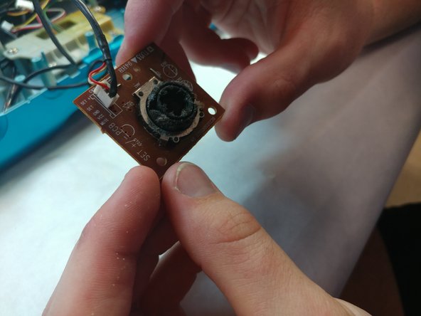

  12. iHome iH3L Scroll Wheel Circuit Board  Replacement: crwdns2935265:012crwdnd2935265:01crwdnd2935265:03crwdne2935265:0 iHome iH3L Scroll Wheel Circuit Board  Replacement: crwdns2935265:012crwdnd2935265:02crwdnd2935265:03crwdne2935265:0 iHome iH3L Scroll Wheel Circuit Board  Replacement: crwdns2935265:012crwdnd2935265:03crwdnd2935265:03crwdne2935265:0
    • With the screws removed, gently pull the scroll wheel circuit board up.
    • Repeat for the other scroll wheel circuit board.
    • Do not yank it off, the wire will still be connected to it.

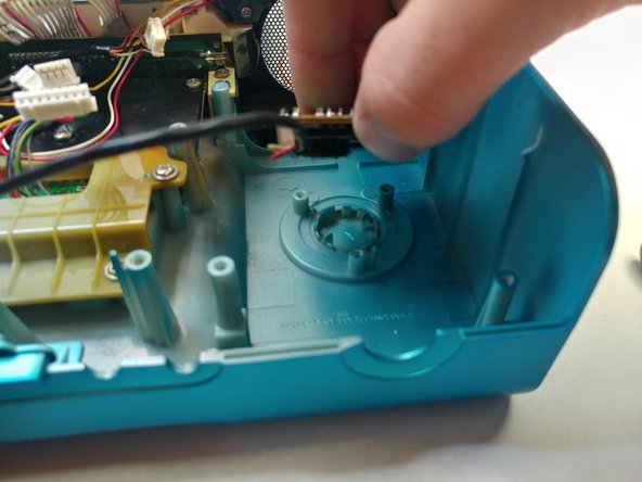

  13. iHome iH3L Scroll Wheel Circuit Board  Replacement: crwdns2935265:013crwdnd2935265:01crwdnd2935265:01crwdne2935265:0
    • The connector to the scroll wheel has already been disconnected from the motherboard.
    • Untangling the wires might be necessary to completely remove it.
