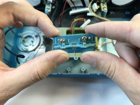

  11. iHome iH3L Clock Buttons Replacement, Clock Adjustment Buttons: crwdns2935265:011crwdnd2935265:01crwdnd2935265:01crwdne2935265:0
    • At this point the buttons should be free of obstruction and easily accessible.
    • Unscrew the two 11.9 mm Phillips #2 screws that are holding the plastic buttons onto the body.
  12. iHome iH3L Clock Buttons Replacement: crwdns2935265:012crwdnd2935265:01crwdnd2935265:02crwdne2935265:0 iHome iH3L Clock Buttons Replacement: crwdns2935265:012crwdnd2935265:02crwdnd2935265:02crwdne2935265:0
    • Once the screws have been removed, simply lift the buttons up and out of their seat.
