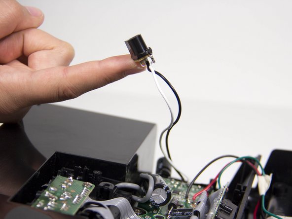

    1. iHome iH27B Power Connector Replacement, Power Connector: crwdns2935265:06crwdnd2935265:01crwdnd2935265:02crwdne2935265:0 iHome iH27B Power Connector Replacement, Power Connector: crwdns2935265:06crwdnd2935265:02crwdnd2935265:02crwdne2935265:0
      • Firmly grasp the power connector, which is the plastic rectangular piece with the white and black wires connected to it.
      • Pull upwards and dislodge the connector.
    2. iHome iH27B Power Connector Replacement: crwdns2935265:07crwdnd2935265:01crwdnd2935265:01crwdne2935265:0
      • Using the scissors on your wire strippers, cut the connecting wires.
      • Using your wire strippers, remove about 1/4 " of the plastic tubing surrounding the end of your exposed wire, careful to not damage the wires.
      • Using a wire-nut or electrician's tape, connect the wires of the replacement power connector to your exposed wires. Connect white wire to white, and black to black.
