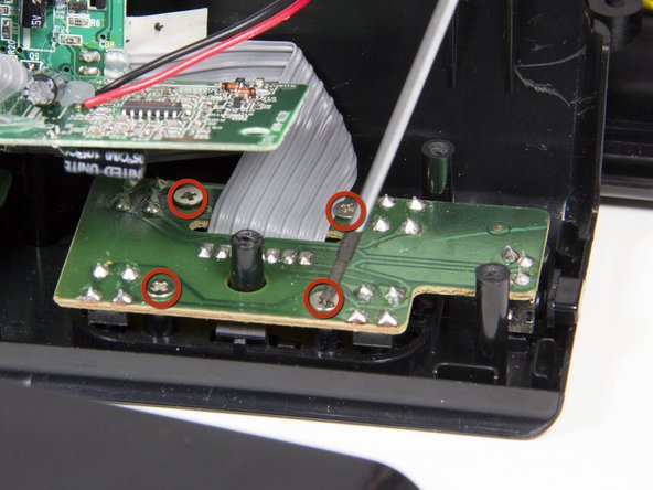

    1. iHome iH27B Left Control Button Replacement, Left Control Button: crwdns2935265:010crwdnd2935265:01crwdnd2935265:02crwdne2935265:0 iHome iH27B Left Control Button Replacement, Left Control Button: crwdns2935265:010crwdnd2935265:02crwdnd2935265:02crwdne2935265:0
      • Remember that the device is still upside down, so the left control button will be on your right hand side. Then rotate the device 180 degrees. You should see the device as it looks in the picture.
      • Carefully lift the iHome about an inch from your surface to verify you are going to the correct spot, because the iHome looks symmetrical at this point.
      • Carefully lift the main motherboard out of the way of the button control circuit board.
      • Remove the following screws:
      • Four 6 mm Phillips #2

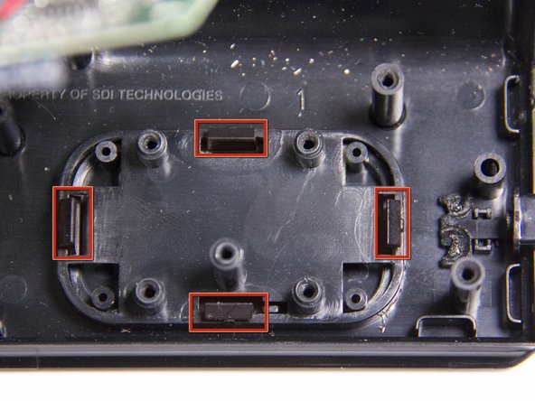

    2. iHome iH27B Left Control Button Replacement: crwdns2935265:011crwdnd2935265:01crwdnd2935265:02crwdne2935265:0 iHome iH27B Left Control Button Replacement: crwdns2935265:011crwdnd2935265:02crwdnd2935265:02crwdne2935265:0
      • Carefully lift the button control motherboard out of the way.
      • Place your fingers on each of the four notches. Apply pressure towards the center, and push downwards until the plastic piece is dislodged from its casing.
      • If your fingers aren't working, use a flathead screwdriver or plastic prying tool to give you extra leverage.
    3. iHome iH27B Left Control Button Replacement: crwdns2935265:012crwdnd2935265:01crwdnd2935265:01crwdne2935265:0
      • Replace your cracked or otherwise broken button with the new button.
