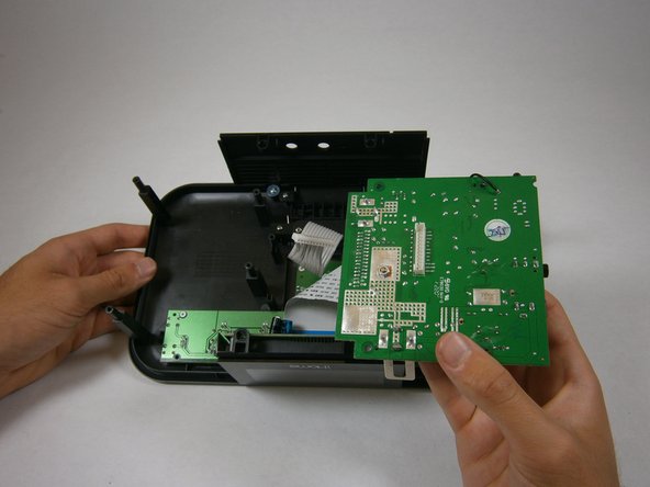

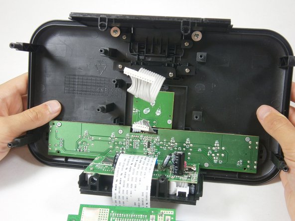

    • Flip the logic board over.
    • Use a plastic opening tool to pry and lift the iPod adapter zip connector from the logic board.
  15. iHome iD95 Screen Cover Replacement: crwdns2935265:015crwdnd2935265:01crwdnd2935265:02crwdne2935265:0 iHome iD95 Screen Cover Replacement: crwdns2935265:015crwdnd2935265:02crwdnd2935265:02crwdne2935265:0
    • Use a plastic opening tool to pry and lift up the white zip connector holding the LCD screen to the buttons.
  16. iHome iD95 Screen Cover Replacement: crwdns2935265:016crwdnd2935265:01crwdnd2935265:02crwdne2935265:0 iHome iD95 Screen Cover Replacement: crwdns2935265:016crwdnd2935265:02crwdnd2935265:02crwdne2935265:0
    • Gently push the screen away from you to dislodge it from the plastic clip holding it in place and then pull up to remove.
  17. iHome iD95 Screen Cover Replacement: crwdns2935265:017crwdnd2935265:01crwdnd2935265:02crwdne2935265:0 iHome iD95 Screen Cover Replacement: crwdns2935265:017crwdnd2935265:02crwdnd2935265:02crwdne2935265:0
    • Use a Phillips #1 screwdriver to unscrew three, 9.5 mm-length 4 mm-head, screws holding the LCD screen to the screen cover.
    • Remove the screen cover from the LCD.
