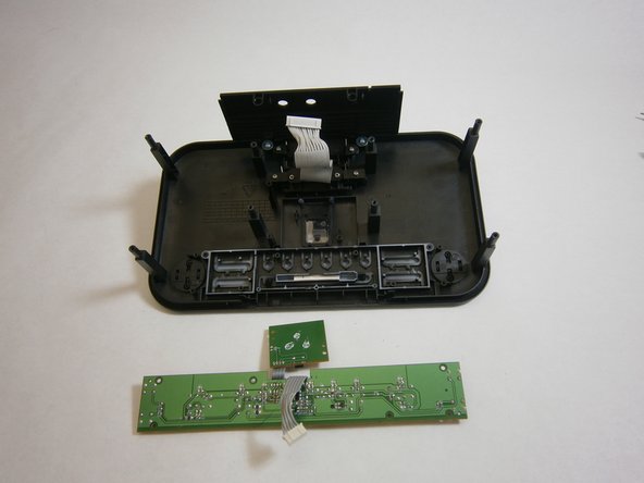

    • Flip the logic board over.
    • Use a plastic opening tool to pry and lift the iPod adapter zip connector from the logic board.
  15. iHome iD95 Button Cover Replacement: crwdns2935265:015crwdnd2935265:01crwdnd2935265:02crwdne2935265:0 iHome iD95 Button Cover Replacement: crwdns2935265:015crwdnd2935265:02crwdnd2935265:02crwdne2935265:0
    • Use a plastic opening tool to pry and lift up the white zip connector attaching the LCD screen to the buttons.
  16. iHome iD95 Button Cover Replacement: crwdns2935265:016crwdnd2935265:01crwdnd2935265:02crwdne2935265:0 iHome iD95 Button Cover Replacement: crwdns2935265:016crwdnd2935265:02crwdnd2935265:02crwdne2935265:0
    • Gently push the screen away from you to dislodge it from the plastic clip holding it in place and then pull up to remove.
  17. iHome iD95 Button Cover Replacement: crwdns2935265:017crwdnd2935265:01crwdnd2935265:02crwdne2935265:0 iHome iD95 Button Cover Replacement: crwdns2935265:017crwdnd2935265:02crwdnd2935265:02crwdne2935265:0
    • Use a Phillips #000 screwdriver to unscrew six, 5 mm-length 5 mm-head, screws attaching the buttons to the case.
  18. iHome iD95 Button Cover Replacement: crwdns2935265:018crwdnd2935265:01crwdnd2935265:02crwdne2935265:0 iHome iD95 Button Cover Replacement: crwdns2935265:018crwdnd2935265:02crwdnd2935265:02crwdne2935265:0
    • Behind the green board is the plastic button cover. Slowly lift it off with your hands.
