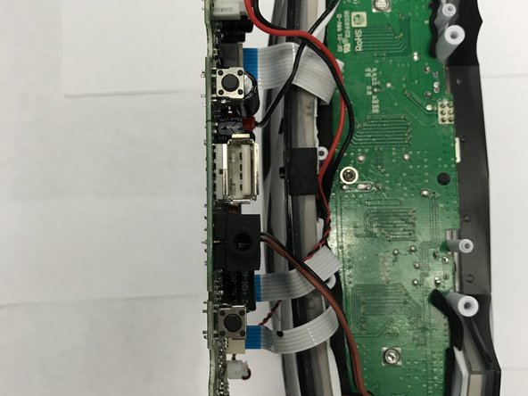

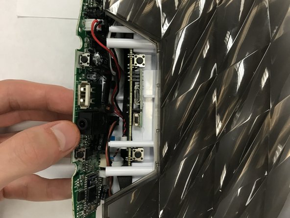

  3. iHome iBT84 Motherboard Replacement: crwdns2935265:03crwdnd2935265:01crwdnd2935265:03crwdne2935265:0 iHome iBT84 Motherboard Replacement: crwdns2935265:03crwdnd2935265:02crwdnd2935265:03crwdne2935265:0 iHome iBT84 Motherboard Replacement: crwdns2935265:03crwdnd2935265:03crwdnd2935265:03crwdne2935265:0
    • You will notice that the triangular black volume piece is loose, make sure to take that off revealing the buttons.
    • Once that is done, the motherboard can be taken out. May require some wiggling.
    • Make sure none of the wires are damaged and that they are all connected.
  4. iHome iBT84 Motherboard Replacement: crwdns2935265:04crwdnd2935265:01crwdnd2935265:01crwdne2935265:0
    • The connections shown here can be taken off by pulling on the white plastic connector piece.
    • The same can be said about the white, paper like, connectors. Pull on them gently.
    • Once all connections are apart, the motherboard is safe to be replaced.
