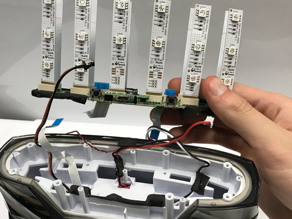

  5. iHome iBT84 Light Fixture Replacement, Light Fixture: crwdns2935265:05crwdnd2935265:01crwdnd2935265:01crwdne2935265:0
    • Use the screwdriver to unscrew the screws on the left and right sides.
  6. iHome iBT84 Light Fixture Replacement: crwdns2935265:06crwdnd2935265:01crwdnd2935265:01crwdne2935265:0
    • Once unscrewed, use the metal spudge to lift the base of the light fixture.
  7. iHome iBT84 Light Fixture Replacement: crwdns2935265:07crwdnd2935265:01crwdnd2935265:02crwdne2935265:0 iHome iBT84 Light Fixture Replacement: crwdns2935265:07crwdnd2935265:02crwdnd2935265:02crwdne2935265:0
    • Lift the base of the light fixture out with the lights.
    • Be careful. The light fixture's can be easily bent.

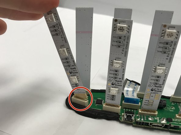

  8. iHome iBT84 Light Fixture Replacement: crwdns2935265:08crwdnd2935265:01crwdnd2935265:02crwdne2935265:0 iHome iBT84 Light Fixture Replacement: crwdns2935265:08crwdnd2935265:02crwdnd2935265:02crwdne2935265:0
    • Pull gently on the individual light fixture that needs to be replaced.
    • Place new individual LED light strip.
