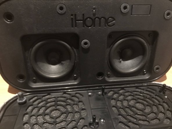

    • Unplug the device and remove the front grille with your hands.
  2. iHome iBT25 Speaker Replacement: crwdns2935265:02crwdnd2935265:01crwdnd2935265:03crwdne2935265:0 iHome iBT25 Speaker Replacement: crwdns2935265:02crwdnd2935265:02crwdnd2935265:03crwdne2935265:0 iHome iBT25 Speaker Replacement: crwdns2935265:02crwdnd2935265:03crwdnd2935265:03crwdne2935265:0
    • You can use this guide to replace either one, or both speakers.

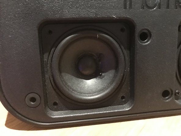

    • Remove the 4 screws surrounding the speaker you want to remove with a phillips head screwdriver
    • All the screws are the same size

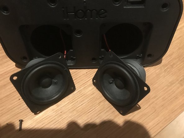

  4. iHome iBT25 Speaker Replacement: crwdns2935265:04crwdnd2935265:01crwdnd2935265:02crwdne2935265:0 iHome iBT25 Speaker Replacement: crwdns2935265:04crwdnd2935265:02crwdnd2935265:02crwdne2935265:0
    • The speaker can now be pulled out or removed by tilting the device.

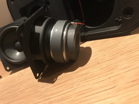

  5. iHome iBT25 Speaker Replacement: crwdns2935265:05crwdnd2935265:01crwdnd2935265:03crwdne2935265:0 iHome iBT25 Speaker Replacement: crwdns2935265:05crwdnd2935265:02crwdnd2935265:03crwdne2935265:0 iHome iBT25 Speaker Replacement: crwdns2935265:05crwdnd2935265:03crwdnd2935265:03crwdne2935265:0
    • The speakers use color coded wires, which don't fit into the wrong side, so you can't get the sides mized up.
    • To remove a wire, grip it where the wire part meets the metal beneath the plastic protector (which is not necessary to remove)
    • pull away from the connector. The black socket is narrower than the red socket.
