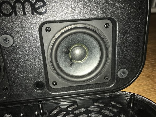

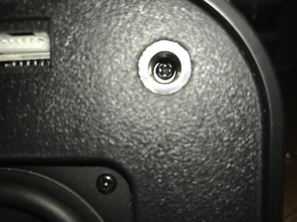

    • Remove the grille with your hands
    • Remove all the rubber inserts still left on the speaker side. If any are on the grill side, you can ignore them.
  2. iHome iBT25 Motherboard Replacement: crwdns2935265:02crwdnd2935265:01crwdnd2935265:03crwdne2935265:0 iHome iBT25 Motherboard Replacement: crwdns2935265:02crwdnd2935265:02crwdnd2935265:03crwdne2935265:0 iHome iBT25 Motherboard Replacement: crwdns2935265:02crwdnd2935265:03crwdnd2935265:03crwdne2935265:0
    • Remove the screws surrounding both speakers.
  3. iHome iBT25 Motherboard Replacement: crwdns2935265:03crwdnd2935265:01crwdnd2935265:02crwdne2935265:0 iHome iBT25 Motherboard Replacement: crwdns2935265:03crwdnd2935265:02crwdnd2935265:02crwdne2935265:0
    • Remove these 3 screws, which were below the rubber inserts you removed earlier.

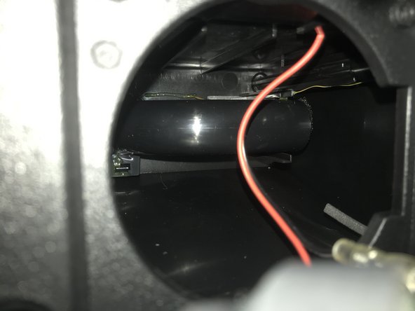

  4. iHome iBT25 Motherboard Replacement: crwdns2935265:04crwdnd2935265:01crwdnd2935265:01crwdne2935265:0
    • The face plate and both speakers can now be separated from the body of the device.
    • The speakers are still connected by wires.

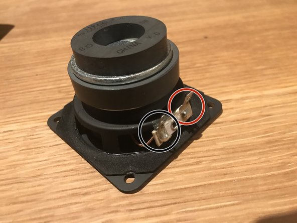

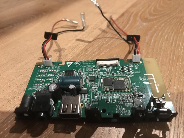

  5. iHome iBT25 Motherboard Replacement: crwdns2935265:05crwdnd2935265:01crwdnd2935265:02crwdne2935265:0 iHome iBT25 Motherboard Replacement: crwdns2935265:05crwdnd2935265:02crwdnd2935265:02crwdne2935265:0
    • Remove the wires, which have different sockets, so they can't be mixed up.

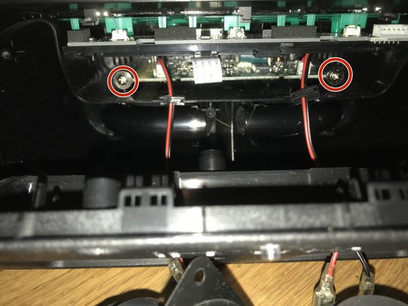

  6. iHome iBT25 Motherboard Replacement: crwdns2935265:06crwdnd2935265:01crwdnd2935265:02crwdne2935265:0 iHome iBT25 Motherboard Replacement: crwdns2935265:06crwdnd2935265:02crwdnd2935265:02crwdne2935265:0
    • With all the speakers and the faceplate removed, you can focus on the motherboard.
    • Remove the 2 indicated screws.

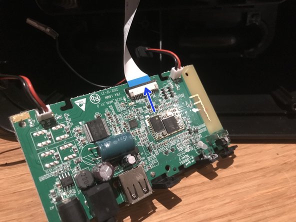

  7. iHome iBT25 Motherboard Replacement: crwdns2935265:07crwdnd2935265:01crwdnd2935265:03crwdne2935265:0 iHome iBT25 Motherboard Replacement: crwdns2935265:07crwdnd2935265:02crwdnd2935265:03crwdne2935265:0 iHome iBT25 Motherboard Replacement: crwdns2935265:07crwdnd2935265:03crwdnd2935265:03crwdne2935265:0
    • Firmly but carefully pull out the motherboard. Before you remove it completely, disconnect the ribbon cable.
    • DO NOT BREAK THE RIBBON CABLE
    • You can now remove the board.
  8. iHome iBT25 Motherboard Replacement: crwdns2935265:08crwdnd2935265:01crwdnd2935265:03crwdne2935265:0 iHome iBT25 Motherboard Replacement: crwdns2935265:08crwdnd2935265:02crwdnd2935265:03crwdne2935265:0 iHome iBT25 Motherboard Replacement: crwdns2935265:08crwdnd2935265:03crwdnd2935265:03crwdne2935265:0
    • Great job! To reassemble, follow these steps in reverse order, and make sure you reattach the ribbon cable with the light blue square facing up.
