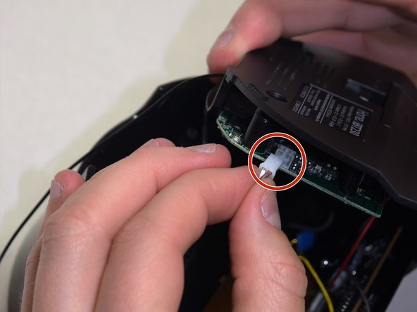

    • Grip the top of the iBT230 by placing your thumb on the back of the iBT230, where the USB port is located. Pull up, and you should notice different colored wires connected to the Main Motherboard.
  3. iHome iBT230 Screen Replacement: crwdns2935265:03crwdnd2935265:01crwdnd2935265:02crwdne2935265:0 iHome iBT230 Screen Replacement: crwdns2935265:03crwdnd2935265:02crwdnd2935265:02crwdne2935265:0
    • Unplug the connectors from all sides of the iBT230, and unplug the wire that is connected to the screen.

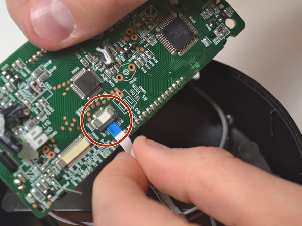

  5. iHome iBT230 Screen Replacement: crwdns2935265:05crwdnd2935265:01crwdnd2935265:02crwdne2935265:0 iHome iBT230 Screen Replacement: crwdns2935265:05crwdnd2935265:02crwdnd2935265:02crwdne2935265:0
    • Once the four 5.5 mm Phillips #00 face panel screws come out, slide the screen out vertically. Set the screen aside.
    • Disconnect the blue tipped ribbon, from the back of the screen.
