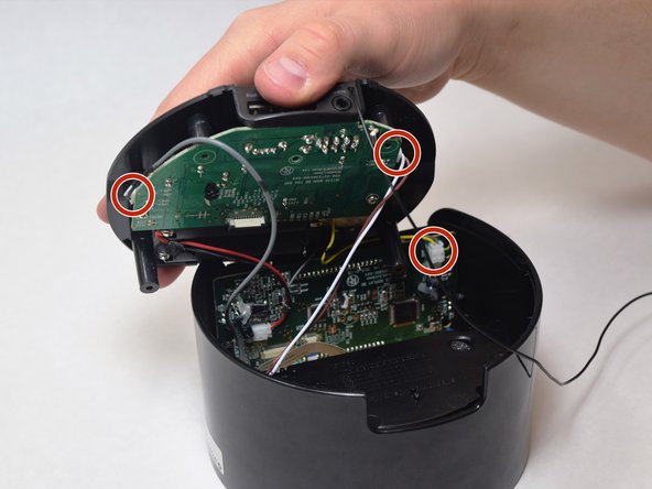

      • Grip the top of the iBT230 by placing your thumb on the back portion, where the USB port is located. Pull up, and you should notice various different colored wires, connected to the Main Motherboard.

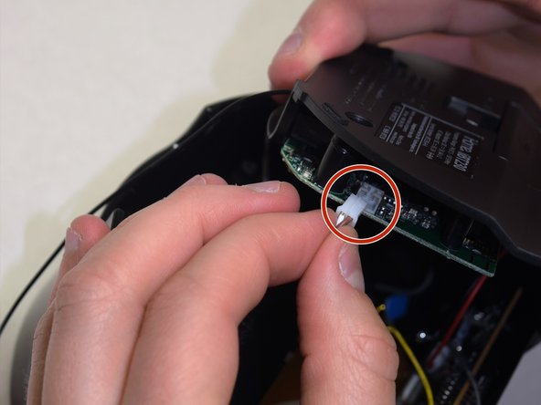

      • Unplug the connectors from all sides of the iBT230, and unplug the wire connected to the screen.
      • Make sure to note which wire goes where, you don't want to re-solder the wires into the incorrect ports!

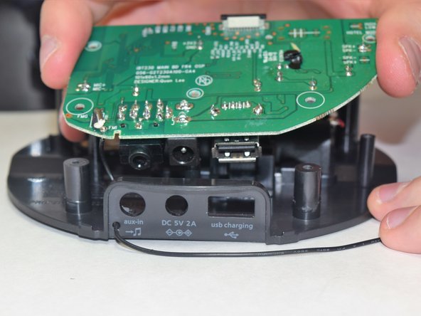

      • On the bottom component where the green Main Motherboard is located, remove the two 5.5 mm Phillips #00 screws.
      • The old Motherboard will come free from the bottom of the iBT230.
