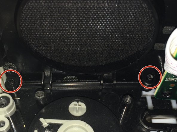

    • All the screws are size 2 except for the ones in Step 9.
    • Flip the iHome upside down.
    • You should see six pocketed Phillip's head screws.
    • You should also see 2 visible Phillip head screws.
    • Using a long neck Phillips head screwdriver, remove the screws.
    • The long neck screwdriver is only necessary for this step. If it works well in the following steps, that is fine; just be sure to use the right tool for the right job.

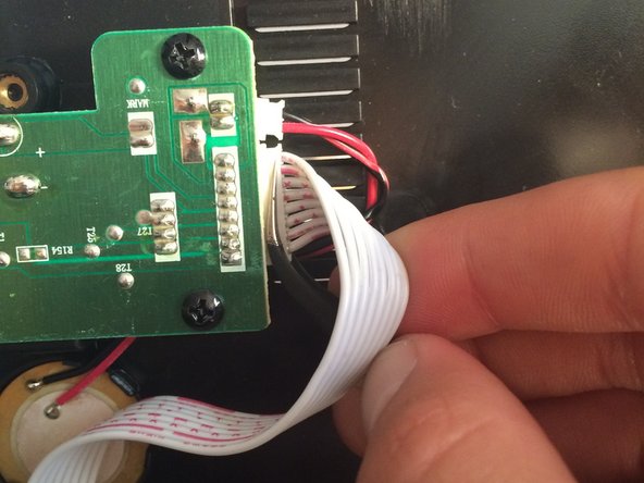

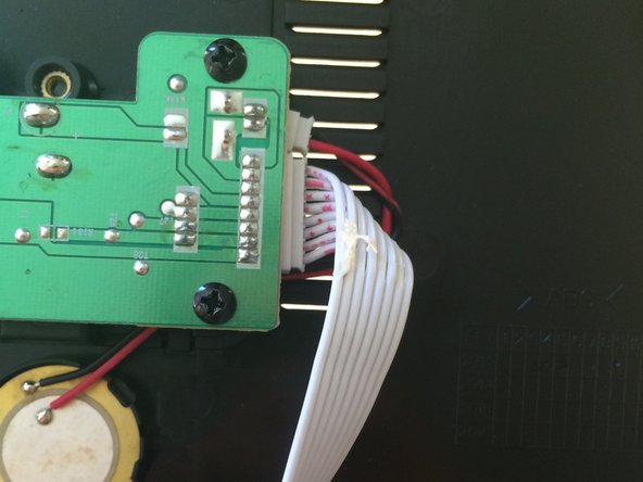

    • Using a pair of tweezers, remove the ribbon cable connector at the backup battery.
    • Be sure not to tug on the cables themselves. This could result in damaging the cables.
    • If tweezers are too difficult to use, it is ok to use your fingers, just so long as you don't put a lot of tension on the cables.

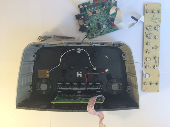

  4. iHome iBN97 Display Screen Replacement, Logic Board Removal: crwdns2935265:04crwdnd2935265:01crwdnd2935265:02crwdne2935265:0 iHome iBN97 Display Screen Replacement, Logic Board Removal: crwdns2935265:04crwdnd2935265:02crwdnd2935265:02crwdne2935265:0

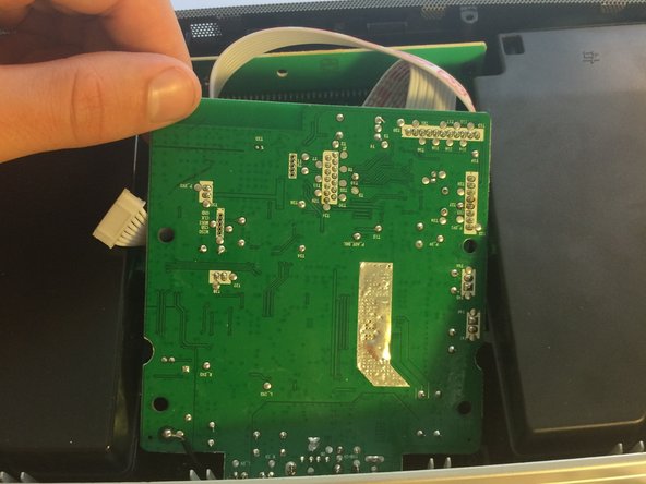

    • Remove the 4 screws located on the logic board.
    • Gently lift the front side of the board towards you
    • Careful not to pull it out forcefully, there are still many cables attached to the logic board.
  5. iHome iBN97 Display Screen Replacement, Logic Board Connections Removal: crwdns2935265:05crwdnd2935265:01crwdnd2935265:02crwdne2935265:0 iHome iBN97 Display Screen Replacement, Logic Board Connections Removal: crwdns2935265:05crwdnd2935265:02crwdnd2935265:02crwdne2935265:0
    • Remove the 4 two-wire extension cables and the ribbon cable connected to the unit.
    • The logic board will still be attached to the unit by a flat ribbon cable and a radio wire.
    • Set the logic board next to the unit.

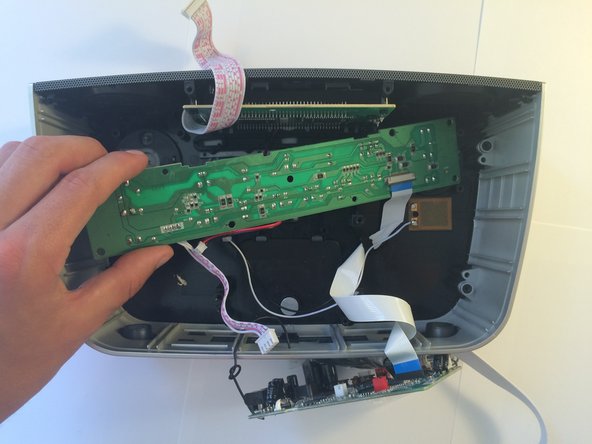

  8. iHome iBN97 Display Screen Replacement, Switch Board Removal: crwdns2935265:08crwdnd2935265:01crwdnd2935265:03crwdne2935265:0 iHome iBN97 Display Screen Replacement, Switch Board Removal: crwdns2935265:08crwdnd2935265:02crwdnd2935265:03crwdne2935265:0 iHome iBN97 Display Screen Replacement, Switch Board Removal: crwdns2935265:08crwdnd2935265:03crwdnd2935265:03crwdne2935265:0
    • Remove the 9 Phillips screws that fasten the switch board to the unit.
    • Remove the switch board and place it outside of the unit, out of the way.
    • The switch board is attached by a flat ribbon cable to the logic board, which is tethered to the unit by a radio wire. It shouldn't get in the way, however.

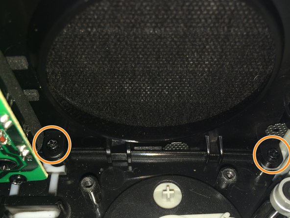

    • If your screwdriver is small enough to fit inside the width of the case, this step is not necessary. Skip ahead to Step 11 and perform the step inside the case.
    • Using the size 1 Phillips screwdriver, remove the 4 Phillips head screws that hold the different parts of the case together.

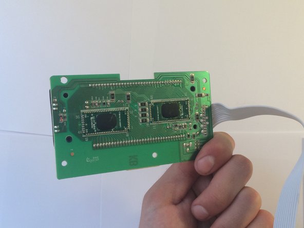

  11. iHome iBN97 Display Screen Replacement, Time Screen Display Removal: crwdns2935265:011crwdnd2935265:01crwdnd2935265:03crwdne2935265:0 iHome iBN97 Display Screen Replacement, Time Screen Display Removal: crwdns2935265:011crwdnd2935265:02crwdnd2935265:03crwdne2935265:0 iHome iBN97 Display Screen Replacement, Time Screen Display Removal: crwdns2935265:011crwdnd2935265:03crwdnd2935265:03crwdne2935265:0
    • Remove the 8 Phillips screws and remove the time display screen.
    • These screws are size 2 again.
