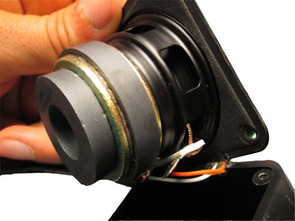

  5. iHome IH11 Speaker Replacement: crwdns2935265:05crwdnd2935265:01crwdnd2935265:01crwdne2935265:0
    • Unsolder the two wires that connect to the speaker.
