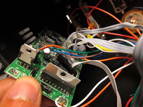

  5. iHome IH11 Main Motherboard Replacement: crwdns2935265:05crwdnd2935265:01crwdnd2935265:01crwdne2935265:0
    • Solder each wire to corresponding input on the motherboard.
