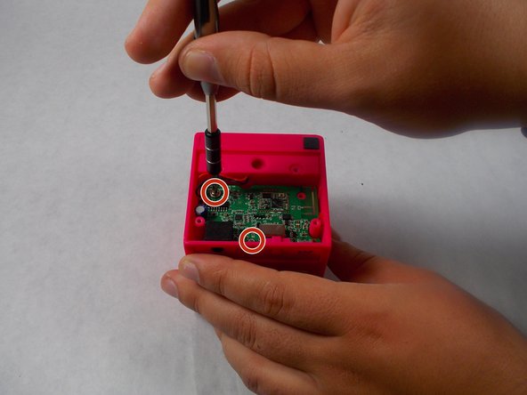

    1. iHome IBT16 Power Switch Replacement, Power Switch: crwdns2935265:03crwdnd2935265:01crwdnd2935265:02crwdne2935265:0 iHome IBT16 Power Switch Replacement, Power Switch: crwdns2935265:03crwdnd2935265:02crwdnd2935265:02crwdne2935265:0
      • Using the Philips #00 screwdriver, unscrew and remove the two silver 10mm screws holding the motherboard
      • Don't misplace the screws! Keep them in a safe place while working on the device
      • Make sure to ground yourself prior to continuing at this point
    2. iHome IBT16 Power Switch Replacement: crwdns2935265:04crwdnd2935265:01crwdnd2935265:01crwdne2935265:0
      • Using the plastic opening tool, pull the motherboard out of the casing
      • Make sure to lift it out at an angle to the back, as the plastic power switch is attached to the board and can be broken

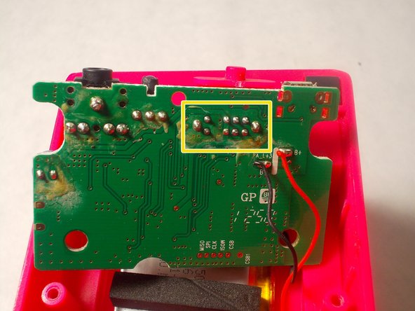

    3. iHome IBT16 Power Switch Replacement: crwdns2935265:05crwdnd2935265:01crwdnd2935265:02crwdne2935265:0 iHome IBT16 Power Switch Replacement: crwdns2935265:05crwdnd2935265:02crwdnd2935265:02crwdne2935265:0
      • Desolder the 10 points holding the power switch to the motherboard
      • Once complete, simply remove the switch from the board
