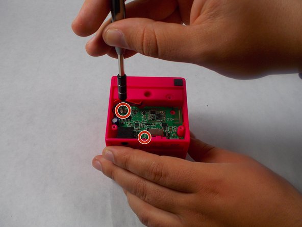

  3. iHome IBT16 Auxiliary Port Replacement, Auxiliary Port: crwdns2935265:03crwdnd2935265:01crwdnd2935265:02crwdne2935265:0 iHome IBT16 Auxiliary Port Replacement, Auxiliary Port: crwdns2935265:03crwdnd2935265:02crwdnd2935265:02crwdne2935265:0
    • Using the Philips #00 screwdriver, unscrew and remove the two silver 10mm screws holding the motherboard
    • Don't misplace the screws! Keep them in a safe place while working on the device
    • Make sure to ground yourself prior to continuing at this point
  4. iHome IBT16 Auxiliary Port Replacement: crwdns2935265:04crwdnd2935265:01crwdnd2935265:01crwdne2935265:0
    • Using the plastic opening tool, pull the motherboard out of the casing
    • Make sure to lift it out at an angle to the back, as the plastic power switch is attached to the board and can be broken
