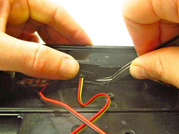

    • Locate the iPhone/iPod input that is in the center of the console.
    • Push the black plastic input stand to the left, and up, with your index finger.
    • Use tweezers to wedge the input stand out of its slot.
  6. iHip Fold-up Portable Speaker iPod/iPhone Input Replacement, Removing iPod/iPhone Input: crwdns2935265:06crwdnd2935265:01crwdnd2935265:01crwdne2935265:0
    • Pull out the iPod/iPhone input with tweezers.

  11. iHip Fold-up Portable Speaker iPod/iPhone Input Replacement, Positioning New iPod/iPhone Input Into Original Position: crwdns2935265:011crwdnd2935265:01crwdnd2935265:01crwdne2935265:0
    • With tweezers, insert the end of the iPod/iPhone input through its designated hole.
    • Note: The device has been rotated 90 degrees to the left in this picture.
    • With both thumbs, push in the black plastic input stand until it snaps into place.
