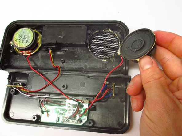

  5. iHip Fold-up Portable Speaker Replacement, Locating Speakers: crwdns2935265:05crwdnd2935265:01crwdnd2935265:01crwdne2935265:0
    • Locate the two individual speakers on either side of the front cover.

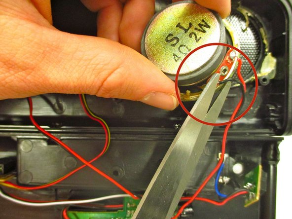

  6. iHip Fold-up Portable Speaker Replacement, Removing Individual Speakers: crwdns2935265:06crwdnd2935265:01crwdnd2935265:03crwdne2935265:0 iHip Fold-up Portable Speaker Replacement, Removing Individual Speakers: crwdns2935265:06crwdnd2935265:02crwdnd2935265:03crwdne2935265:0 iHip Fold-up Portable Speaker Replacement, Removing Individual Speakers: crwdns2935265:06crwdnd2935265:03crwdnd2935265:03crwdne2935265:0
    • Use a plastic opening tool to scrape off the glue around the speakers.
    • Gently pull the speaker up to detach it from the front cover.
    • Desolder the black and red wires from the speaker unit.
    • Use a hot glue gun to secure the new speaker. Solder the black and red speaker wires back in place.
