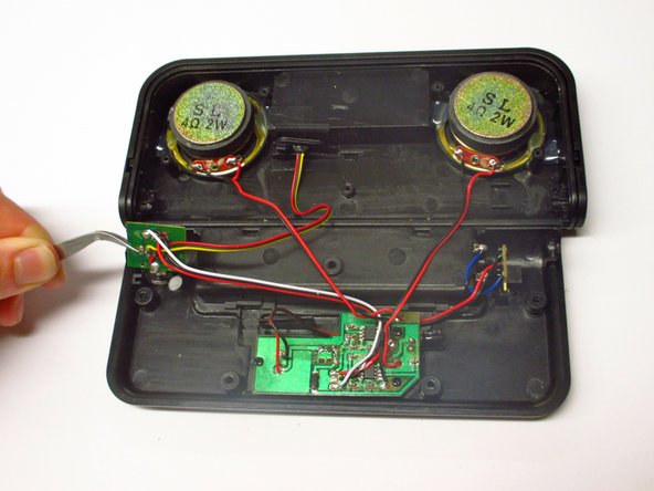

  5. iHip Fold-up Portable Speaker LINE IN ADAPTER Replacement, Locating the LINE IN Adapter: crwdns2935265:05crwdnd2935265:01crwdnd2935265:02crwdne2935265:0 iHip Fold-up Portable Speaker LINE IN ADAPTER Replacement, Locating the LINE IN Adapter: crwdns2935265:05crwdnd2935265:02crwdnd2935265:02crwdne2935265:0
    • Position the portable speaker device so that the back cover and the speaker are both laying flat, giving you access to the inside of the device
    • If the motherboard is at the bottom when you are looking down at the device, the LINE IN adapter should be on the left side of the back cover
    • Carefully remove the LINE IN adapter using a pair of tweezers
  6. iHip Fold-up Portable Speaker LINE IN ADAPTER Replacement, Removing the Adapter: crwdns2935265:06crwdnd2935265:01crwdnd2935265:01crwdne2935265:0
    • Remove the black and red wires attached to the LINE IN adapter that extend from the motherboard by cutting them with scissors
    • Repeat previous step for the blue and second black wire connecting the adapter to the battery case.
    • At this point, you should be able to carefully remove the entire faulty adapter and the wires.
  7. iHip Fold-up Portable Speaker LINE IN ADAPTER Replacement, Assembling the New Adapter: crwdns2935265:07crwdnd2935265:01crwdnd2935265:01crwdne2935265:0
    • Position the newly purchased LINE IN adapter and wires in place
    • Using a soldering iron and soldering wire, reattach the red and black wires that extend from the motherboard to their original position on the LINE IN adapter
    • Use the soldering iron and soldering wire again to reattach the black and blue wires that extend from the battery case to their original position on the LINE IN adapter
    • The blue wire should attach on the bottom of the battery case and the black wire on the top insertion.
    • The new LINE IN adapter should now be properly assembled in place with the wires connected to their proper location.
