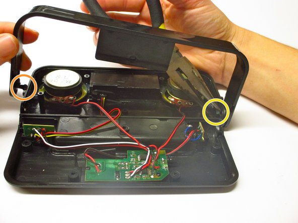

  6. iHip Fold-Up Portable Speaker Stand Replacement, Removing the Stand: crwdns2935265:06crwdnd2935265:01crwdnd2935265:02crwdne2935265:0 iHip Fold-Up Portable Speaker Stand Replacement, Removing the Stand: crwdns2935265:06crwdnd2935265:02crwdnd2935265:02crwdne2935265:0
    • Locate the two small connection points for the stand.
    • Using small needle nose pliers, pinch the end of the stand toward the side of the speaker case.
    • Pop the end of the stand out of the hole in the side of the speaker case.
    • Repeat this step for the opposite side of the stand.
  7. iHip Fold-Up Portable Speaker Stand Replacement, Connecting The New Stand: crwdns2935265:07crwdnd2935265:01crwdnd2935265:01crwdne2935265:0
    • 1. Position the new stand perpendicular to the speaker case.
    • 2. Align the bulbs at the end of the stand with the holes in the side of the speaker case.
    • 3. Gently push the bulbs into the holes of the speaker case.
    • 4. Pull the stand back around the speaker system.
