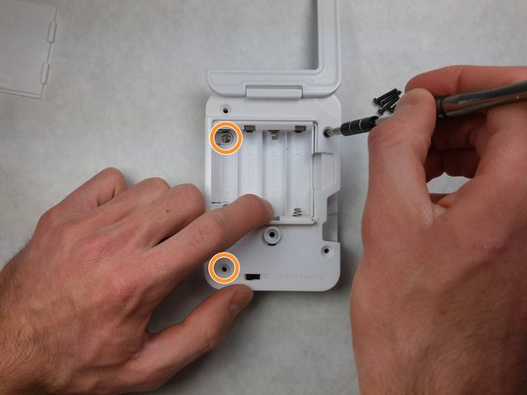

    • Remove five black 10 mm Phillips #0 screws from the back side of the device.
    • Remove two silver-colored 5 mm Phillips from the left side of the internal cover.
