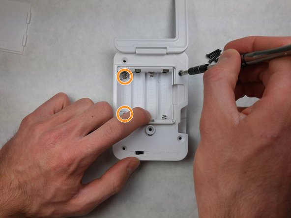

    • Place the front screen of the device on a flat surface, this allows access to the back cover. Remove the back cover from the device to access the batteries.
  2. iDevices iGrill Power Delivery Wires and Springs Replacement: crwdns2935265:02crwdnd2935265:01crwdnd2935265:01crwdne2935265:0
    • Remove the batteries from the device, allowing you to access the screws necessary for removal of the back panel.
  3. iDevices iGrill Power Delivery Wires and Springs Replacement: crwdns2935265:03crwdnd2935265:01crwdnd2935265:02crwdne2935265:0 iDevices iGrill Power Delivery Wires and Springs Replacement: crwdns2935265:03crwdnd2935265:02crwdnd2935265:02crwdne2935265:0
    • Remove five black 10 mm Phillips #0 screws from the back side of the device.
    • Remove two silver-colored 5 mm Phillips screws from the left side of the internal cover.

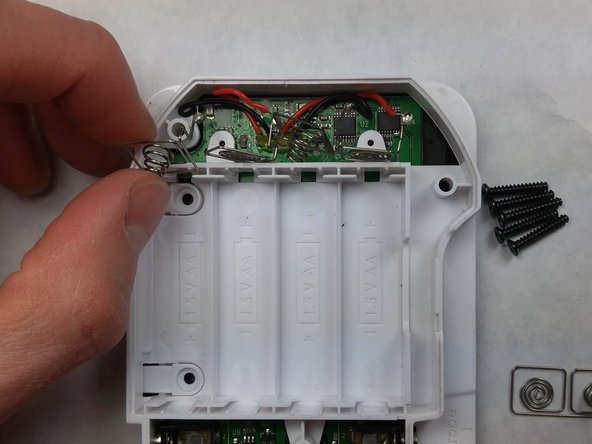

    • Gently and slowly pull the back cover off of the iGrill, exposing the power cables to the motherboard.
  5. iDevices iGrill Power Delivery Wires and Springs Replacement: crwdns2935265:05crwdnd2935265:01crwdnd2935265:02crwdne2935265:0 iDevices iGrill Power Delivery Wires and Springs Replacement: crwdns2935265:05crwdnd2935265:02crwdnd2935265:02crwdne2935265:0
    • Gently pull the metal terminals to the batteries out of their plastic holders.
    • Position the metal terminals such that you will be able to pull the plastic component that holds the batteries away from the motherboard.
    • Remove the internal cover from the device.
  6. iDevices iGrill Power Delivery Wires and Springs Replacement: crwdns2935265:06crwdnd2935265:01crwdnd2935265:01crwdne2935265:0
    • After you have peeled back the rear plastic covering, you will have access to the motherboard.
  7. iDevices iGrill Power Delivery Wires and Springs Replacement: crwdns2935265:07crwdnd2935265:01crwdnd2935265:01crwdne2935265:0
    • From here, you will have access to both the metal terminals of the power transfer wires and the soldering points of the power transfer wires to the motherboard.
    • If any of these connections have been broken, repair them with a solder and soldering wire.
