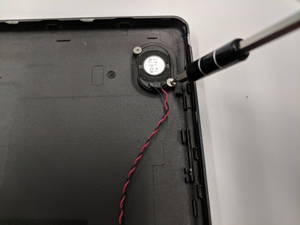

    • On the tablet’s back cover, locate the two 4 mm screws on the speaker.
    • Use the #000 Phillips screwdriver to remove the screws and place them in an appropriate location.

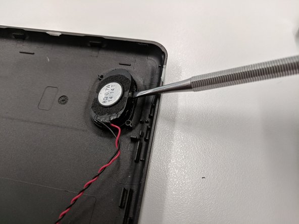

    • Using a metal spudger, safely separate the speaker from its socket.

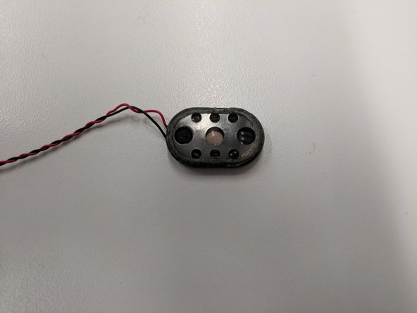

  5. iDeaUSA CT8 Speaker Replacement: crwdns2935265:05crwdnd2935265:01crwdnd2935265:02crwdne2935265:0 iDeaUSA CT8 Speaker Replacement: crwdns2935265:05crwdnd2935265:02crwdnd2935265:02crwdne2935265:0
    • The speaker is now removed and can be replaced accordingly.
    • Remember that to ensure a connection, you will need to solder the new wire connections onto the motherboard.
