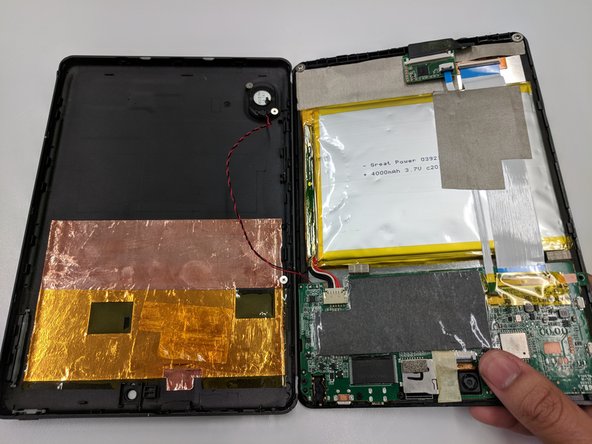

    • Place the tablet on a flat surface, facing upwards.
    • Starting from the portholes, use the plastic opening tools to remove the back cover of the tablet from the top half.
    • Being cautious of the wire connecting the speaker and the motherboard, place the front and back portion of the tablet close in proximity.

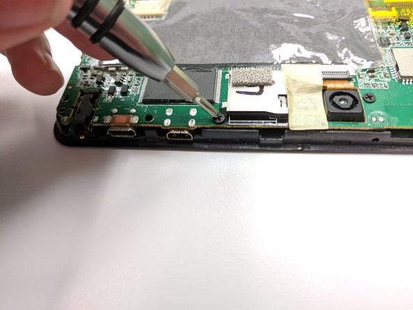

    • With the screen facing down, locate the two 4 mm screws at the top of the tablet.
    • Use the #00 Phillips screwdriver to remove the screws and place them in a safe location.

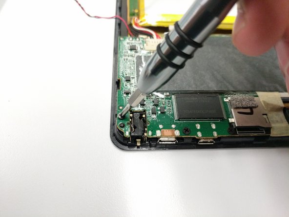

    • Locate the five 3.5 mm black screws on the motherboard.
    • Use the #00 Phillips screwdriver to remove the screws, place them in an appropriate location.

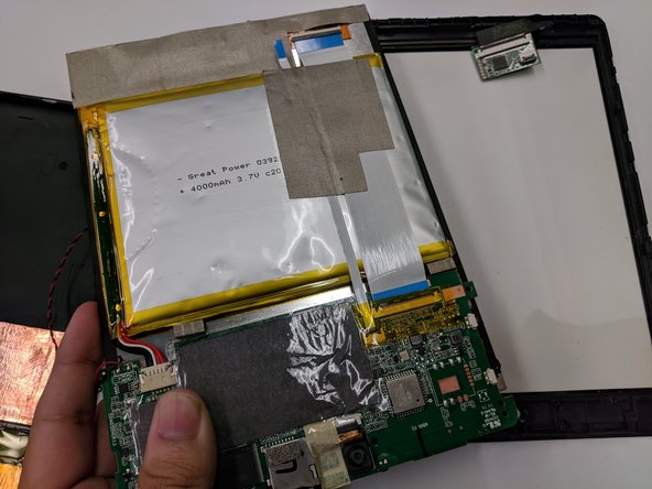

    • After removing the 5 screws from the motherboard, carefully lift it up.

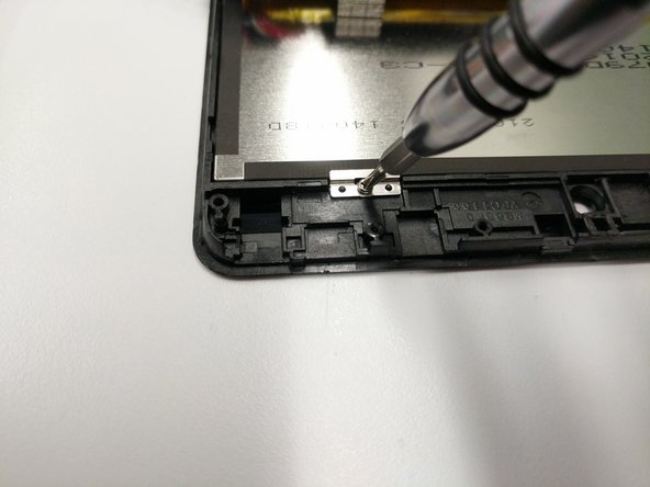

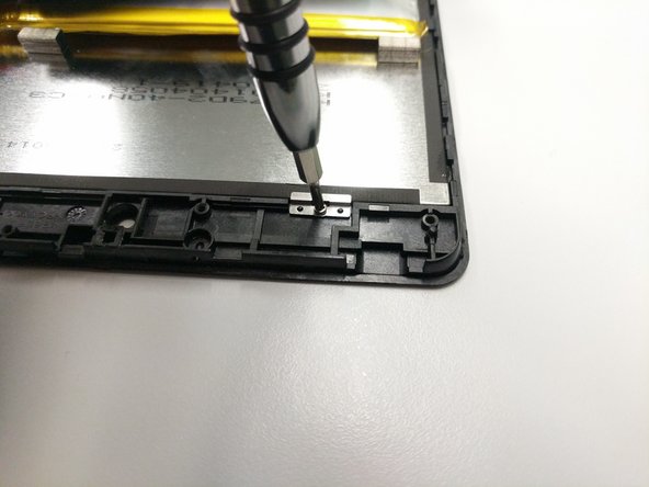

    • Upon lifting the motherboard, two metal plates that hold the touch sensor and the screen together can now be seen.
    • Once again, use the #00 Phillips screwdriver to remove the two 3 mm screws and plates.
