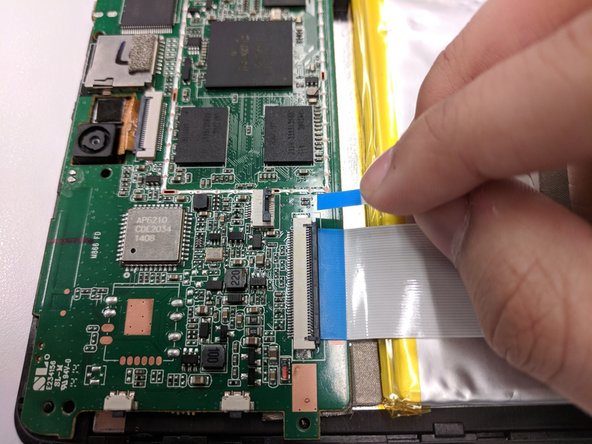

    • Carefully peel off the tape covering the circuit boards and blue ribbons. The tape can be disposed or saved for reuse.
  4. iDeaUSA CT8 Motherboard Replacement: crwdns2935265:04crwdnd2935265:01crwdnd2935265:03crwdne2935265:0 iDeaUSA CT8 Motherboard Replacement: crwdns2935265:04crwdnd2935265:02crwdnd2935265:03crwdne2935265:0 iDeaUSA CT8 Motherboard Replacement: crwdns2935265:04crwdnd2935265:03crwdnd2935265:03crwdne2935265:0

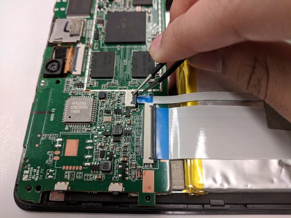

    • After removing the tape, two blue ribbon wires can now be accessed. To disconnect, gently lift up the plastic ZIF tabs covering the wires.
    • Upon lifting the tab, the ribbons can now be safely pulled out of their connections.
    • To avoid breaking or damaging the plastic ZIF tabs, it is recommended to use tweezers.

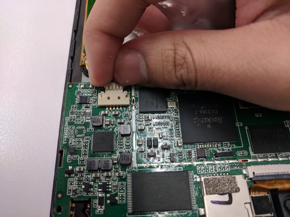

    • Disconnect the wires connecting the battery to the motherboard.
    • Start from the sides and gently wiggle the connection out until it;s loose enough to pull.

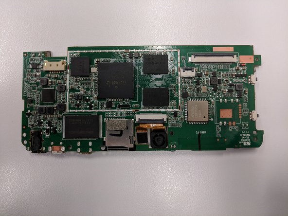

    • Pull out and free the motherboard from its position.
