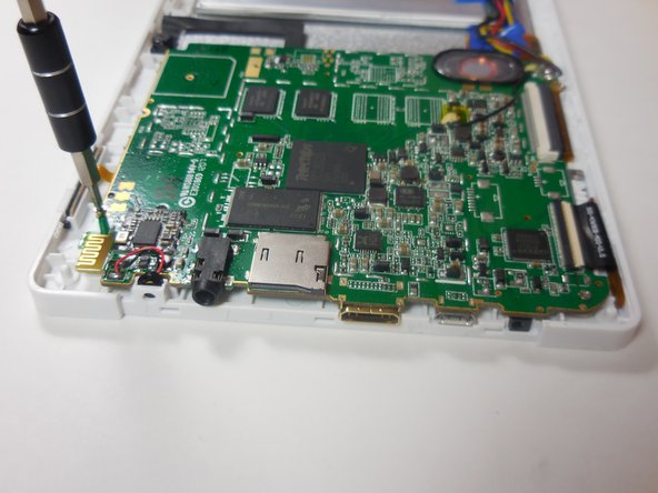

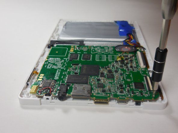

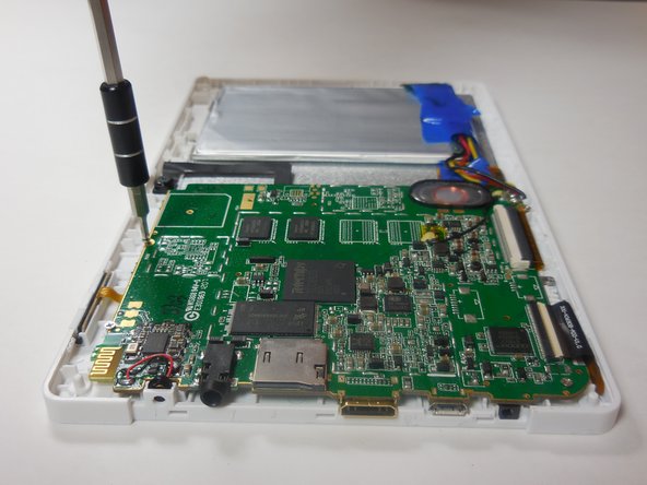

    • Once the back cover has been removed the device should look like this.
    • Remove the motherboard by unscrewing the four 4 mm screws along the edges of the board using a Philips 00 screwdriver.

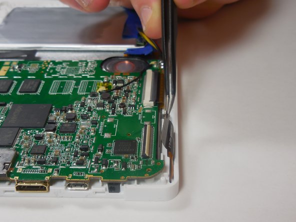

  4. iDea USA CT702 Speaker  Replacement: crwdns2935265:04crwdnd2935265:01crwdnd2935265:02crwdne2935265:0 iDea USA CT702 Speaker  Replacement: crwdns2935265:04crwdnd2935265:02crwdnd2935265:02crwdne2935265:0

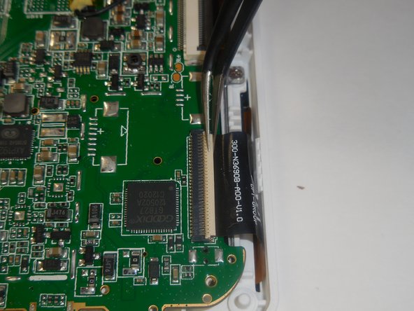

    • After removing the four screws, disconnect the two ribbon wires; to disconnect the wire lift up on on the plastic tab covering the wire.
    • When the tab is in the up position gently pull the ribbon wire out of its connection.
  5. iDea USA CT702 Speaker  Replacement: crwdns2935265:05crwdnd2935265:01crwdnd2935265:01crwdne2935265:0
    • Once the ribbon wires are disconnected, gently lift up on the mother board and flip it.
    • All of the wires have not been disconnected from the motherboard. Be careful not to damage the remaining wires.

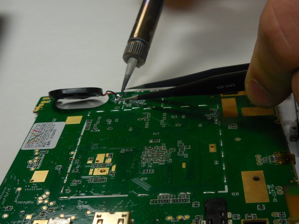

  6. iDea USA CT702 Speaker  Replacement: crwdns2935265:06crwdnd2935265:01crwdnd2935265:03crwdne2935265:0 iDea USA CT702 Speaker  Replacement: crwdns2935265:06crwdnd2935265:02crwdnd2935265:03crwdne2935265:0 iDea USA CT702 Speaker  Replacement: crwdns2935265:06crwdnd2935265:03crwdnd2935265:03crwdne2935265:0

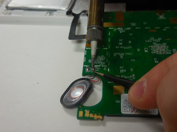

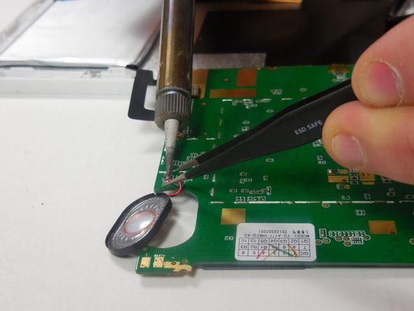

    • The speaker is located towards the edge of the motherboard. You will need to solder the speaker connections to remove it.
    • Your speaker may have a mesh cover and may not look like the one in the picture.
    • To solder the connections apart take the hot soldering iron and gently touch it to the end of the wire at the connection to the motherboard. At the same time use tweezers to gently pull the wire away from the connection.
  7. iDea USA CT702 Speaker  Replacement: crwdns2935265:07crwdnd2935265:01crwdnd2935265:03crwdne2935265:0 iDea USA CT702 Speaker  Replacement: crwdns2935265:07crwdnd2935265:02crwdnd2935265:03crwdne2935265:0 iDea USA CT702 Speaker  Replacement: crwdns2935265:07crwdnd2935265:03crwdnd2935265:03crwdne2935265:0

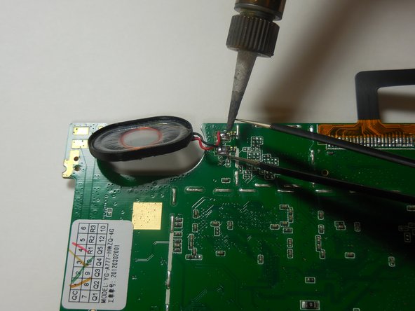

    • To connect the new speaker you will need to solder the new wire connections onto the motherboard.
    • Gently touch the end of the new wire to the existing connection, and use the soldering iron to heat the solder and connect the wire.
    • You will need to do this for both of the speaker connections.

    • Once the new speaker is connected, gently lift the motherboard and place it back in the frame. Be sure to line up the holes to screw back in place.
    • Make sure the speaker is in its original place before screwing the device back together.
    • Use a Philips 00 screwdriver to screw in the four 4 mm screws along the edge of the motherboard.
