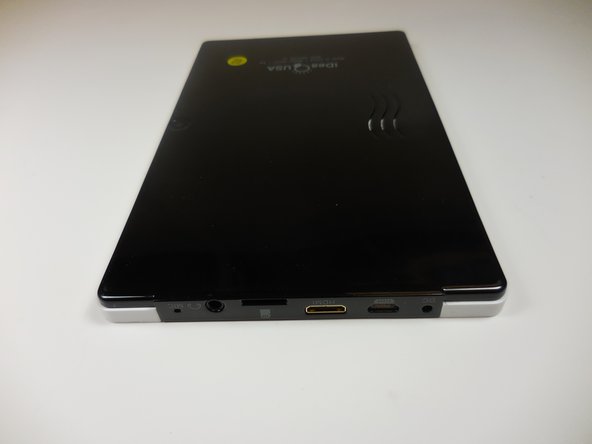

    • Place tablet on the table with screen facing upright.
    • Starting from the portholes, use plastic opening tool to pry in between the front panel and back cover.
    • Follow the opening along the corners and sides until all latches are unclipped.
    • Remove back cover completely and place it outside of the work area.

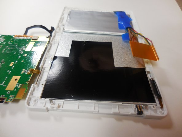

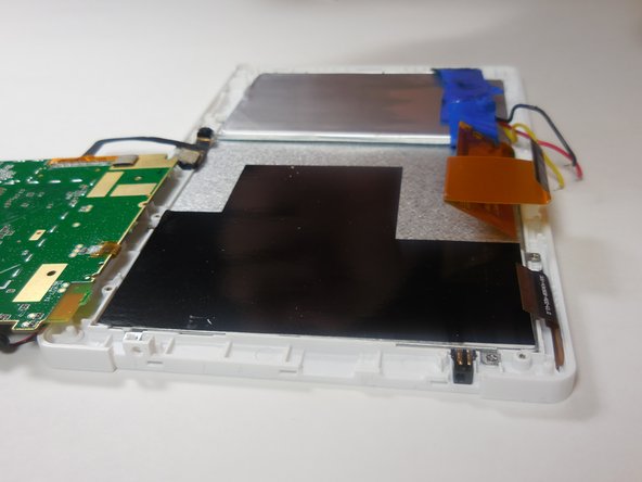

  3. iDea USA CT702 Digitizer Glass Replacement: crwdns2935265:03crwdnd2935265:01crwdnd2935265:03crwdne2935265:0 iDea USA CT702 Digitizer Glass Replacement: crwdns2935265:03crwdnd2935265:02crwdnd2935265:03crwdne2935265:0 iDea USA CT702 Digitizer Glass Replacement: crwdns2935265:03crwdnd2935265:03crwdnd2935265:03crwdne2935265:0
    • After screws are removed, gently pull up on the ribbon wire connection to release all 3 wires from the motherboard.
    • Safely remove mother board and battery from tablet by using tweezers.
    • Make sure the small ribbon wires are not damaged when removing larger members.

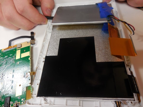

  4. iDea USA CT702 Digitizer Glass Replacement: crwdns2935265:04crwdnd2935265:01crwdnd2935265:01crwdne2935265:0
    • Remove tape from battery pack, and dispose.
    • Be careful not to touch the wire/battery connection correctly, as it could result in injury.

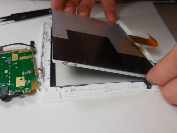

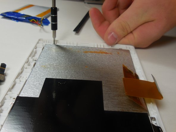

  5. iDea USA CT702 Digitizer Glass Replacement: crwdns2935265:05crwdnd2935265:01crwdnd2935265:03crwdne2935265:0 iDea USA CT702 Digitizer Glass Replacement: crwdns2935265:05crwdnd2935265:02crwdnd2935265:03crwdne2935265:0 iDea USA CT702 Digitizer Glass Replacement: crwdns2935265:05crwdnd2935265:03crwdnd2935265:03crwdne2935265:0
    • After removing the battery pack and motherboard, the touch sensor unit should be visible.
    • Use small Philips screw driver to unscrew all 6 of the 2mm screws.
    • Use fingers and prying tool to remove the touch sensor unit from frame.

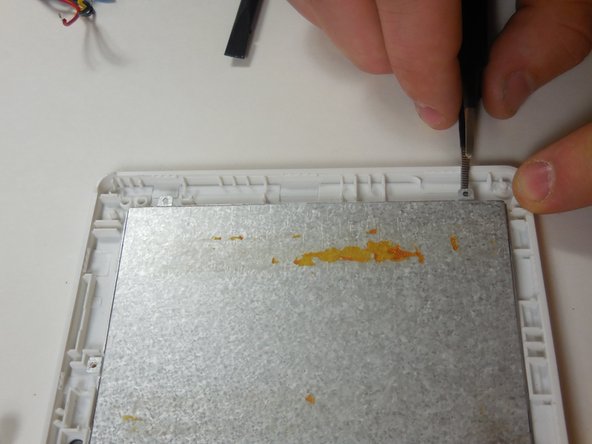

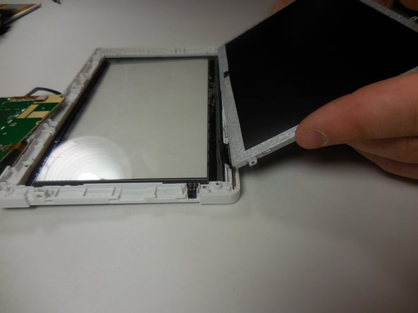

  6. iDea USA CT702 Digitizer Glass Replacement: crwdns2935265:06crwdnd2935265:01crwdnd2935265:03crwdne2935265:0 iDea USA CT702 Digitizer Glass Replacement: crwdns2935265:06crwdnd2935265:02crwdnd2935265:03crwdne2935265:0 iDea USA CT702 Digitizer Glass Replacement: crwdns2935265:06crwdnd2935265:03crwdnd2935265:03crwdne2935265:0
    • After the touch sensor is detached, only the plastic screen should remain.
    • Insert new touch sensor plate into the same position, aligning all screw inputs.
    • Insert all six of the 2mm. screws to connect the new touch sensor to the screen frame.
