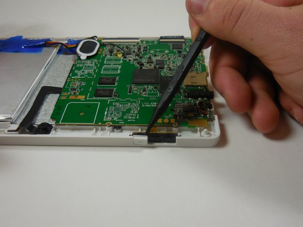

  3. iDea USA CT702 Button Replacement: crwdns2935265:03crwdnd2935265:01crwdnd2935265:02crwdne2935265:0 iDea USA CT702 Button Replacement: crwdns2935265:03crwdnd2935265:02crwdnd2935265:02crwdne2935265:0
    • With a plastic spudger tool, pry the keys away from the black key mat to remove them.
    • It is easiest to start with the volume up button key and then work on freeing the next two.

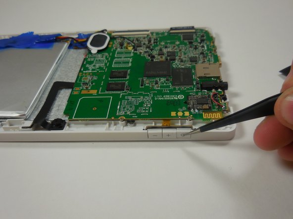

  4. iDea USA CT702 Button Replacement: crwdns2935265:04crwdnd2935265:01crwdnd2935265:02crwdne2935265:0 iDea USA CT702 Button Replacement: crwdns2935265:04crwdnd2935265:02crwdnd2935265:02crwdne2935265:0
    • Replace the button keys, starting with the outer and ending with the innermost key.
    • The back of each button key has a notch that matches an indent on the black button mat. Match the notches and the indents to properly align the buttons.
    • To replace the back cover, follow the first three steps in reverse order.
