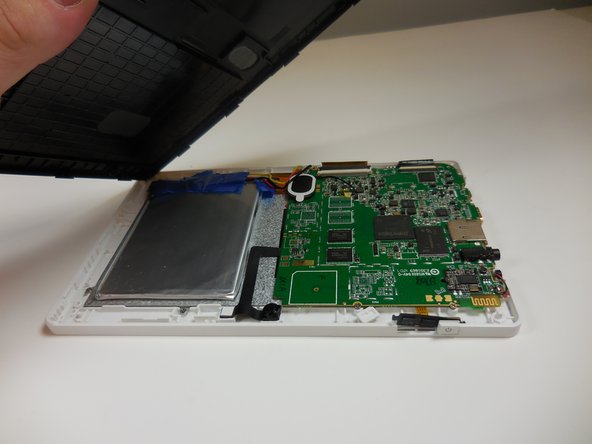

    • Face the tablet with portholes facing you.
  2. iDea USA CT702 Battery Replacement: crwdns2935265:02crwdnd2935265:01crwdnd2935265:01crwdne2935265:0
    • Use a fingernail or a plastic opening tool to gently pry the black panel around the portholes.
    • Be gentle and take your time.

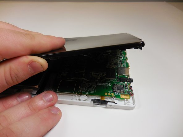

  3. iDea USA CT702 Battery Replacement: crwdns2935265:03crwdnd2935265:01crwdnd2935265:03crwdne2935265:0 iDea USA CT702 Battery Replacement: crwdns2935265:03crwdnd2935265:02crwdnd2935265:03crwdne2935265:0 iDea USA CT702 Battery Replacement: crwdns2935265:03crwdnd2935265:03crwdnd2935265:03crwdne2935265:0
    • Use your fingers to remove the rest of the back. Slowly apply pressure from each side to detach each clip connection.

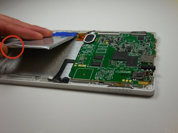

  4. iDea USA CT702 Battery Replacement: crwdns2935265:04crwdnd2935265:01crwdnd2935265:02crwdne2935265:0 iDea USA CT702 Battery Replacement: crwdns2935265:04crwdnd2935265:02crwdnd2935265:02crwdne2935265:0
    • Separate the battery from the device.
    • Slowly use your thumb and forefingers to pry open each corner.
    • Be aware of the adhesive on the bottom of the battery. Remove with care to keep battery intact.

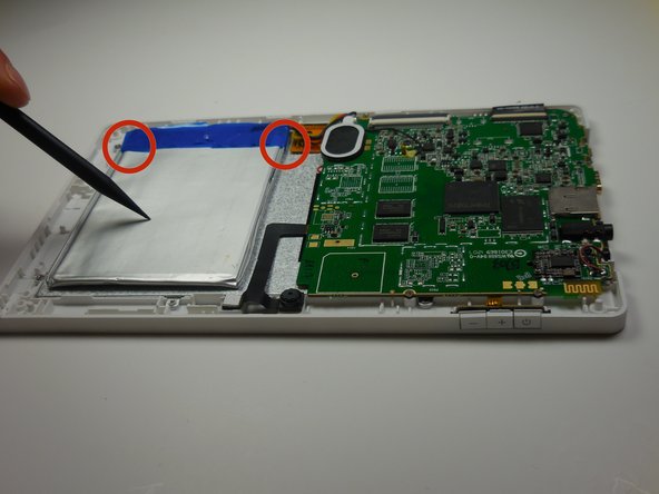

  5. iDea USA CT702 Battery Replacement: crwdns2935265:05crwdnd2935265:01crwdnd2935265:01crwdne2935265:0
    • Carefully peel off tape around the top of the battery.
    • Slowly use your fingernail to lift the tape off of the battery. Dispose of the tape or save it for reuse.

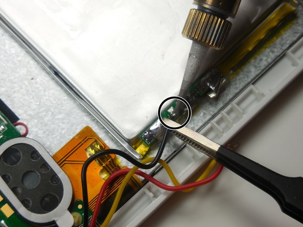

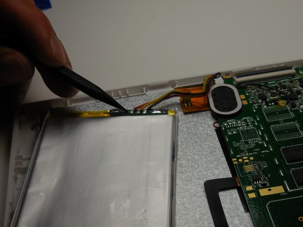

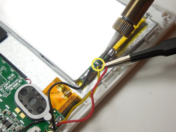

  6. iDea USA CT702 Battery Replacement: crwdns2935265:06crwdnd2935265:01crwdnd2935265:03crwdne2935265:0 iDea USA CT702 Battery Replacement: crwdns2935265:06crwdnd2935265:02crwdnd2935265:03crwdne2935265:0 iDea USA CT702 Battery Replacement: crwdns2935265:06crwdnd2935265:03crwdnd2935265:03crwdne2935265:0
    • Disconnect the battery using the soldering iron.
    • Remember to use proper safety precautions when soldering. Solder from the side and do not breathe the smoke in.
    • Make sure the soldering iron is on the highest heat for 5 minutes before starting.
    • Start with the red wire, and gently touch the tip of the iron onto the connection.
    • Move to the yellow wire after the red.
    • Move to the black wire after the yellow.

  9. iDea USA CT702 Battery Replacement: crwdns2935265:09crwdnd2935265:01crwdnd2935265:02crwdne2935265:0 iDea USA CT702 Battery Replacement: crwdns2935265:09crwdnd2935265:02crwdnd2935265:02crwdne2935265:0
    • Solder the new battery.
    • Start with the black wire and solder to the nearest connection.
    • Move to the yellow wire and solder to the middle connection.
    • End with the red wire and solder to the farthest connection away.
