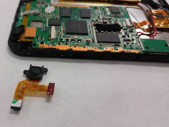

  4. iDea USA CT 1020 Front & Rear Camera Assembly Replacement: crwdns2935265:04crwdnd2935265:01crwdnd2935265:02crwdne2935265:0 iDea USA CT 1020 Front & Rear Camera Assembly Replacement: crwdns2935265:04crwdnd2935265:02crwdnd2935265:02crwdne2935265:0
    • The camera is held in place by adhesive material on the back of the camera
    • To complete removal, peel the camera off the mother board
