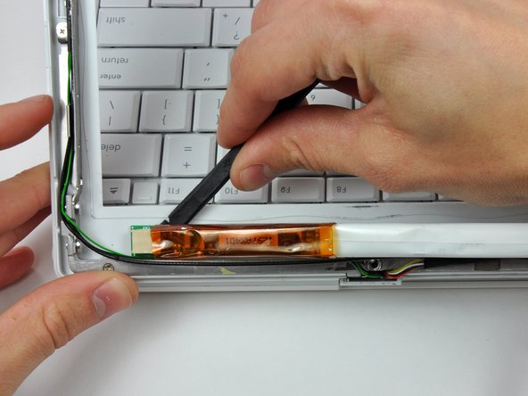

  18. iBook G4 14" 933 MHz-1.33 GHz Display Inverter Replacement, Display Inverter: crwdns2935265:018crwdnd2935265:01crwdnd2935265:01crwdne2935265:0
    • Remove the two pieces of yellow tape covering the inverter/AirPort cables.
  19. iBook G4 14" 933 MHz-1.33 GHz Display Inverter Replacement: crwdns2935265:019crwdnd2935265:01crwdnd2935265:01crwdne2935265:0
    • Disconnect the inverter cable by pulling its connector away from the socket on the inverter board.
    • The inverter board is a very thin and delicate circuit board that is easily broken. Use caution.
    • This connector tends to stick in its socket. It is helpful to push the connector with the tip of a spudger through the two small holes in the top of the socket while pulling the connector away from the socket.
    • Make sure to grasp the inverter cabling by the black tape and not the individual wires. Pulling the wires themselves will surely damage the inverter cable.
  20. iBook G4 14" 933 MHz-1.33 GHz Display Inverter Replacement: crwdns2935265:020crwdnd2935265:01crwdnd2935265:02crwdne2935265:0 iBook G4 14" 933 MHz-1.33 GHz Display Inverter Replacement: crwdns2935265:020crwdnd2935265:02crwdnd2935265:02crwdne2935265:0
    • Insert the flat end of a spudger under the middle of the inverter board.
    • Slide the spudger to the far left and right edges to separate the inverter board from the adhesive securing it to the front bezel.
    • Remove the inverter board.
