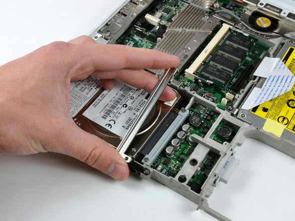

  37. iBook G4 12" 1.33 GHz Logic Board Replacement: crwdns2935265:038crwdnd2935265:01crwdnd2935265:02crwdne2935265:0 iBook G4 12" 1.33 GHz Logic Board Replacement: crwdns2935265:038crwdnd2935265:02crwdnd2935265:02crwdne2935265:0
    • Lift the AirPort antenna cables off the heat sink and set them aside.
    • Lift the metal restraining bracket from the hard drive and place it aside.

  46. iBook G4 12" 1.33 GHz Logic Board Replacement: crwdns2935265:047crwdnd2935265:01crwdnd2935265:01crwdne2935265:0
    • Remove the four Phillips screws securing the hard drive to the metal framework.
  47. iBook G4 12" 1.33 GHz Logic Board Replacement: crwdns2935265:048crwdnd2935265:01crwdnd2935265:01crwdne2935265:0
    • Slightly lift the hard drive from the free end and pull the hard drive straight away from the connector.
  48. iBook G4 12" 1.33 GHz Logic Board Replacement: crwdns2935265:049crwdnd2935265:01crwdnd2935265:01crwdne2935265:0
    • The cable you're about to remove is very fragile - do not pull directly on the wires. Instead, try to pry up the connector directly, using a spudger or a small flathead screwdriver if necessary.
