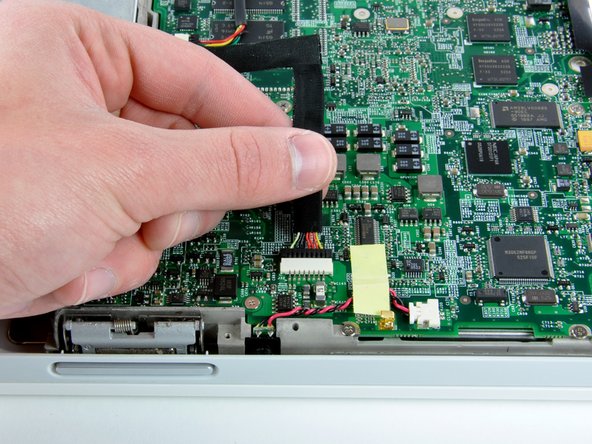

  24. iBook G4 12" 1.33 GHz Hard Drive Replacement: crwdns2935265:025crwdnd2935265:01crwdnd2935265:01crwdne2935265:0
    • Before you can yank the upper case off, you must disconnect the trackpad connector, the blue and white power cable, and speaker cable as described in the next steps. Be especially careful with these cables; never pull directly on the cables, but use a spudger to pry up the connector directly.
    • Carefully lift the upper case slightly and move it toward the front of the computer to reveal the trackpad connector. Use a spudger or your finger to disconnect the trackpad connector hidden beneath the white plastic tab.
    • After disconnecting the track pad connector, carefully rotate the upper case away from you and rest it against the display.
    Although these instructions forewarn that these connectors are fragile, I would suggest emphasizing this in BOLD. When one of these connectors in the next couple steps pulls free from the logic board, as my speaker connector did with very little force, I was told by my Mac repair center that "...you're at the end of the road, period. There's no way we can re-solder that speaker connection". This may not be totally correct because other advice in iFixit suggests it is possible but regardless, the extremely small contact pads that need to be re-soldered really requires removing the entire logic board, experience with very tiny solder projects, and double the time and effort.
    A second tool such as a tiny flat blade screw driver to hold down the connector that is soldered to the logic board while pulling/prying up on the male side of the connector with the spudger so that the soldered portion doesn't rip off the board was found to be helpful.
    This set of instructions however is very complete, just read them carefully.
    crtolson - crwdns2934203:0crwdne2934203:0
    If the speaker connection (step 25) is carefully/successfully removed, it is possible to leave the power button (blue and white, step 26) connector in place and carefully lift the metal cover to access the HD toward the front.
    Follow crtolson's advice, but when prying the connectors, do it one side at a time, and use a LIGHT touch when doing so. Work each side slowly, HOLDING DOWN THE HEADER IN THE CENTER WITH A SMALL FLAT-HEAD PRECISION SCREWDRIVER, pulling up lightly with the spudger once per side. The connector will eventually come loose enough to lift it from the header. DO NOT USE YOUR FINGERS! Always use a spudger.
    The instructions in CAPS are VERY important, lest you pull the header off the board. I've made this mistake myself, and I've been working on Mac notebooks for 20 years...
    CL Johnson - crwdns2934203:0crwdne2934203:0
    Prying with spudger... Connector "walked out" with socket on logic board.(contacts were intact, solder is pretty bad after those years)It is like a lottery. I had to use great force to separate these two afterwards.
    Adam Panák - crwdns2934203:0crwdne2934203:0

    • Using the sharp end of a spudger, disconnect the connector for the blue and white power cables. Again, be careful to pry up only on the connector.
    • It is very easy to break the connector from the board, so be careful.
    • The key is to apply force in two directions, down to keep the surface board connections intact, up to release the connector.
    • The upper case is now free and can be removed from the computer.
    Be careful with this step, when I did I was stuck with glue on the cable connector of the card.
    JCarlos19 - crwdns2934203:0crwdne2934203:0
    Warning, be extremly carful with this step! I lift the hole socket from the board. :(
    Its not cool to have a new "big" HD in a computer without powerbutton!
    And belive me it is really a tiny work to solder it in place again.
    hugobass - crwdns2934203:0crwdne2934203:0
    There is a rectangular magnet on the underneath side of the upper case assembly near the CD-ROM. Be sure it is in place or the "close lid and sleep" function will not work.
    apenzott - crwdns2934203:0crwdne2934203:0
    There is actually no need to remove the power plug if you are careful with the placement of the top cover. I had the whole plug pull of the board and had to solder it back again. Not an easy task had to use a magnifying glass to see it.
    john50 - crwdns2934203:0crwdne2934203:0
    crwdns2936937:0john50crwdne2936937:0
    I wish I had read John's comment! I thought I was being careful to unplug without pulling and I pulled the whole plug out of the board too : ( I've never soldered anything before.......
    Ann - crwdns2934203:0crwdne2934203:0
    As noted above, be very careful!
    I also had the whole plug come off the board and had to solder it back. Definitely try and do it without removing the blue & white power cable.
    Matt - crwdns2934203:0crwdne2934203:0
    Ditto. I didn't even notice that I'd torn the connector off the logic board until I went to put it all back together. It really is way too tight a connection and since you have so little room to work, it's VERY hard to pull it out without damage.
    If you break this connection, anything else you're doing won't matter. Go slow, get a magnifying glass and perhaps try to hold town the part that's connected to the logic board as you attempt to pull out the connector....
    If you have any problems or think that you can't do this, I'd say that you should stop, button it all back up and bring it to someone. Even a cheap, used logic board is around $250-350 -- and that's not worth it.
    dylewski - crwdns2934203:0crwdne2934203:0
    crwdns2936937:0Mattcrwdne2936937:0
    Several people have mentioned soldering the plug back.......How exactly did you achieve this?! Are you experienced with micro-soldering? Were you able to salvage your laptop?! Although I got good advice to take it to a tv/electronics shop and have them solder the blue and white cables directly to the board, I have not done this. The comp is still neatly packaged by teardown step and sitting in a cardboard box. It's really annoying to look at this useless box of components that used to be a very nice little laptop : (
    I would love to hear how you managed the repair.
    Ann
    crwdns2936937:0Anncrwdne2936937:0
    Ann
    The plug has two holes in the back that slot into two pins on the board.
    I slotted the pins in and the two wires on the front of the plug that need soldering to the board line up where they attach to the board.
    I used a soldering iron with a flat tip (like a flat-head screwdriver) and pressed on the two wires at the same time for a second or two. That was long enough to melt the solder and reattach the wires. It took two attempts to get it attached correctly.
    I didn't add any extra solder and I haven't had much experience with soldering.
    Thanks Matt! That was a very complete description. My son (mechanical engineering student.....unfortunately, not electrical...lol) has some equipment. I'm hoping that he can manage it when he comes home this weekend. I do see the pins on the board and the two wires.
    Thanks again sharing your approach!
    Ann
    crwdns2936937:0JCarlos19crwdne2936937:0
    DO NOT PRY!!!! just toasted my iBook following this lousy advise. Try pulling from the wires very lightly instead or cut back the surrounding metal to get a better approach. If anyone has a high res scan of the area surrounding the the plug and where to solder connection, I melted the socket and am now resorting to soldering directly to the board but its not going well.
    eric - crwdns2934203:0crwdne2934203:0
    It is NOT necessary to remove these cables. Just flip the upper case on the screen and secure it with a little tape and nothing can happen to this delicate connection!
    Everling - crwdns2934203:0crwdne2934203:0
    Man, this step is really hard. The hardest step of the iBook guide. It is possible to carefully wiggle it out. Bit by bit, wiggle the plug gently back and forth ever so slightly, so that it comes out. It is SO easy to break it. I've done it before. With patience, it can be done. Just take your time.
    Jonas Kvale - crwdns2934203:0crwdne2934203:0
    If you're careful and are able to remove the trackpad connector without damage, it is possible to lean the top case and metal shield against the screen, without having to remove the speaker and power connectors, while you replace the hard drive. You'll have to unstick the speaker cable from the shield first, remove the screws, and reroute the speaker cable out of the notch that it's in. SLOWLY remove the metal shield and CAREFULLY lean it up against the screen.
    Say: wouldn’t it be a Good Idea to simply snip these wires a few inches from the connector, and twist the darn things back together? Don’t touch the delicate little plug! If you’re fussy & neat, the wires can be soldered & shrink tubing slipped over them. Note: I have a G4, but I have NOT done this work ( yet! ) Still…isn’t my idea pretty good?
    Michael Maddan - crwdns2934203:0crwdne2934203:0
    It is pity iI have not done that. Connector survived, but it wiggles and definitely not making good contact.(laptop refuses to power on)
