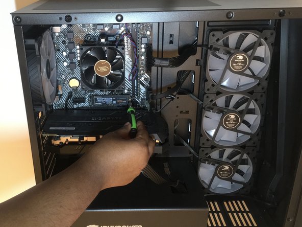

    • Lay the desktop on its side with the glass panel facing up.
    • Remove the single screw.
  2. iBUYPOWER Trace 4 9310 M.2 NVMe Drive Replacement: crwdns2935265:02crwdnd2935265:01crwdnd2935265:02crwdne2935265:0 iBUYPOWER Trace 4 9310 M.2 NVMe Drive Replacement: crwdns2935265:02crwdnd2935265:02crwdnd2935265:02crwdne2935265:0
    • Remove the glass side by pivoting it up with the bottom side still seated in the notches.
    • Lift the glass side out of the notches and set it to the side.

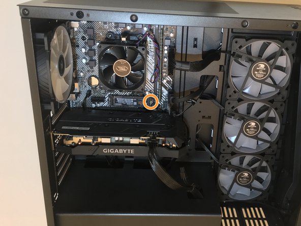

  3. iBUYPOWER Trace 4 9310 M.2 NVMe Drive Replacement: crwdns2935265:03crwdnd2935265:01crwdnd2935265:03crwdne2935265:0 iBUYPOWER Trace 4 9310 M.2 NVMe Drive Replacement: crwdns2935265:03crwdnd2935265:02crwdnd2935265:03crwdne2935265:0 iBUYPOWER Trace 4 9310 M.2 NVMe Drive Replacement: crwdns2935265:03crwdnd2935265:03crwdnd2935265:03crwdne2935265:0
    • Locate the M.2 drive that is right above the CPU.
    • Remove the screw on the edge of the drive.

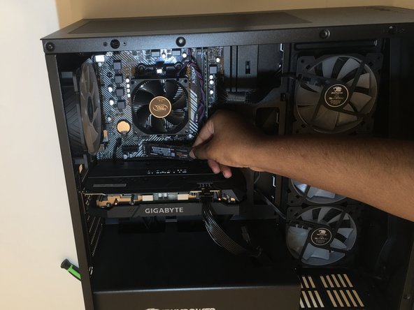

  4. iBUYPOWER Trace 4 9310 M.2 NVMe Drive Replacement: crwdns2935265:04crwdnd2935265:01crwdnd2935265:02crwdne2935265:0 iBUYPOWER Trace 4 9310 M.2 NVMe Drive Replacement: crwdns2935265:04crwdnd2935265:02crwdnd2935265:02crwdne2935265:0
    • The drive should lift up on the edge where the screw was.
    • Pull the drive out at an angle from the motherboard.

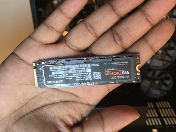

  5. iBUYPOWER Trace 4 9310 M.2 NVMe Drive Replacement: crwdns2935265:05crwdnd2935265:01crwdnd2935265:02crwdne2935265:0 iBUYPOWER Trace 4 9310 M.2 NVMe Drive Replacement: crwdns2935265:05crwdnd2935265:02crwdnd2935265:02crwdne2935265:0
    • Line the new drive up with the slot and gently slide it in.
    • Use one finger to hold the drive down while you screw it back in.
